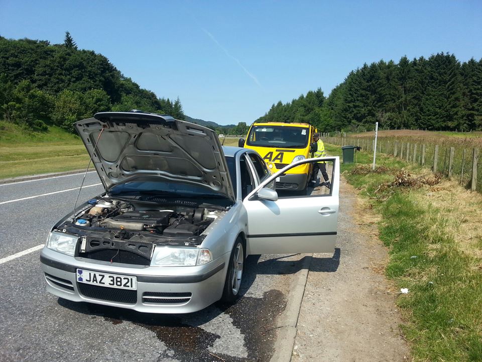

Well, the water pump on the vRS went today. AA recovered back to Aviemore.
