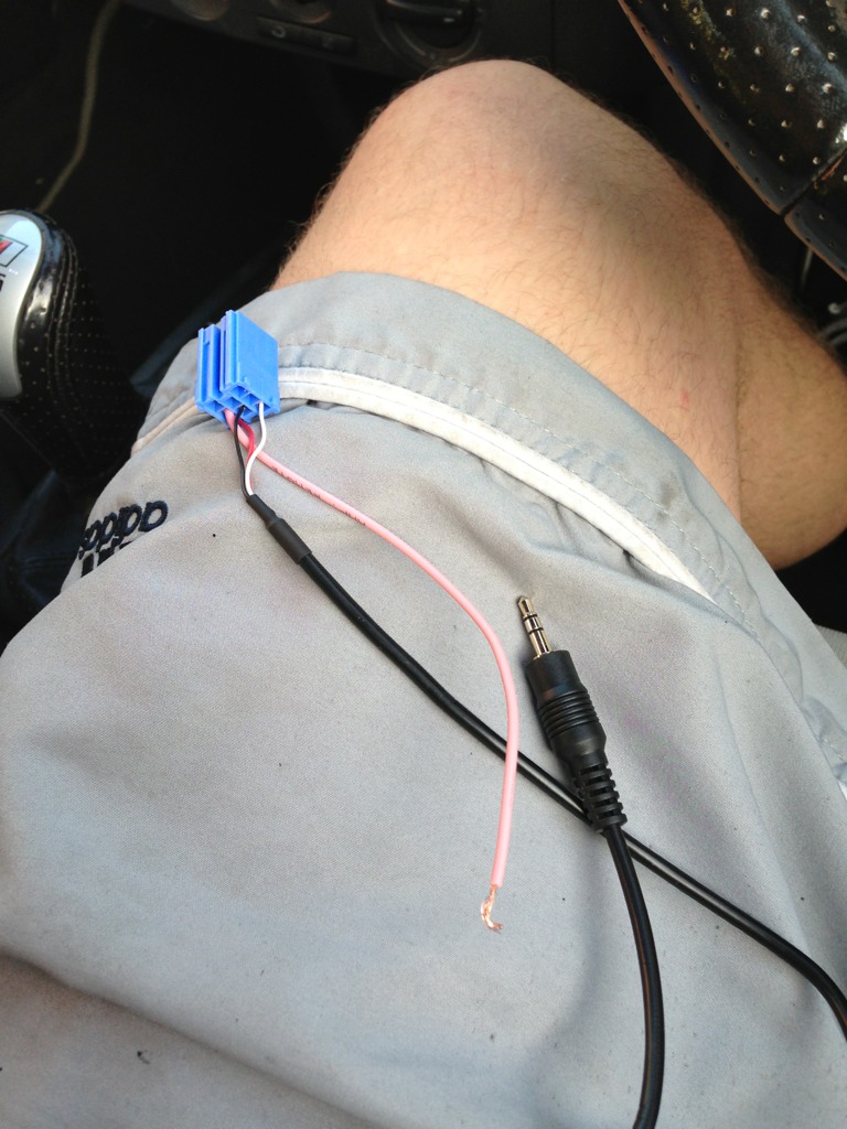

This is what it looks like, I just plugged it in and presumed the pink wire coming off is the earth althought it says on it (amp remote)
try using it without the pink wire connected then?
i did and it didn't pick up anything, when I used the pink you could hear it pick up a signal because the cd started again when you took it off
Mine had no earth cable, was just a headphone jack.

Right, plugged mine in. Not working either. I have the same cable.
Also realised that my CD player is made by technisat.
Going to try earthing.
Tried earthing, didn't work.
Tried switched live, didn't work, perm live, didn't work.
Looks like going to need an emulator.
Unless anyone else has any ideas.
On fabia 1 the aux lead needs to trick the head unit that the cd changer is still connected that lead doesn't look up to that, connects 2 one only around £20 on eBay.
