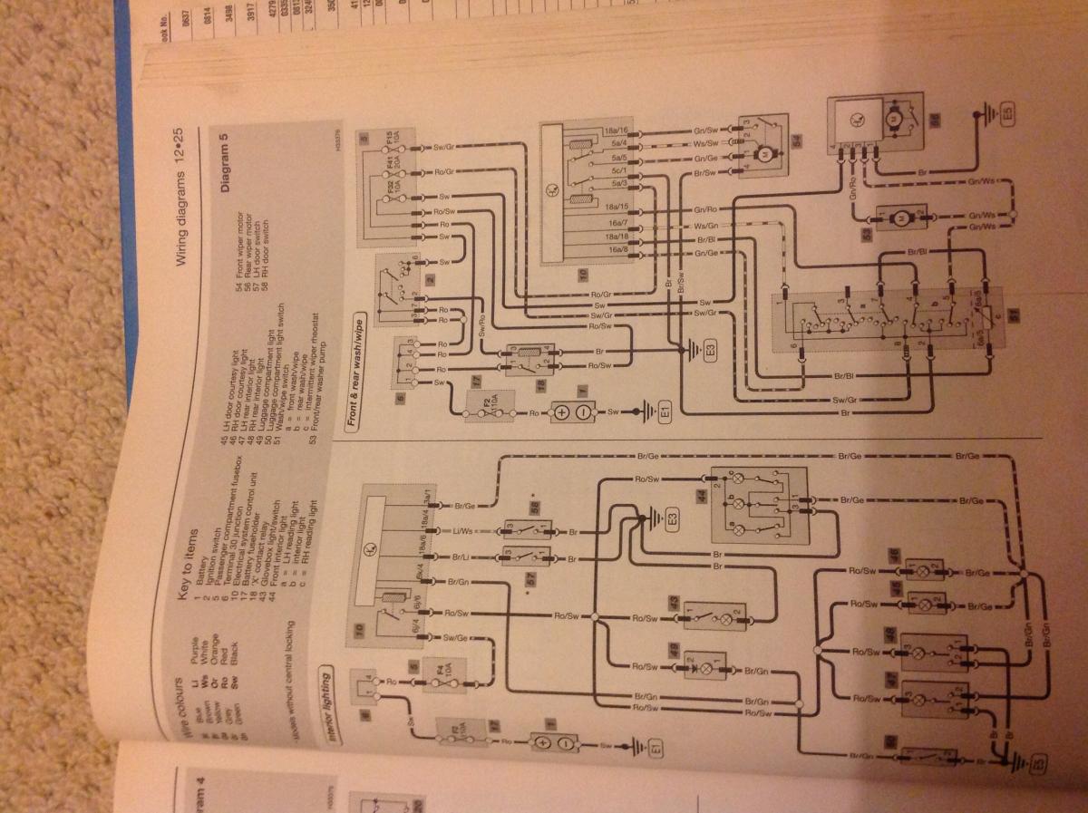

Wiring diagram for you

Me again. Having peeked at the diagram, went on a bit more of a trawl through the old topics. Wino posted a good set of possibilities in this thread: http://www.briskoda.net/forums/topic/351492-interior-light-dead-please-help/
The obvious failure points (assuming glove box etc are off too) are fuse 4 or the comfort module (the relay in it). Bit of a tricky job, even if you decide to just replace the whole module

The 12V supply comes from a relay inside the onboard supply control unit, via connector XP2, a 6-way connector also known as T6j (red-ringed below).
A bad connection where the loom plugs into this point is a possibility; just unplugging and re-connecting this 6-way connector might resolve it.  Access to the connector is the only hassle.
This unit sits above the pedals, with all the connectors facing vertically downwards; don't think you can see much on the Fabia without removing lower dash trim. This is described in various how-to threads, like the one for evaporator temp sensor in the 'Technical Guides' section.
