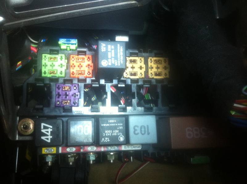

hi im new on the forum and fell a bit weird to ask straight for a help, i vgot skoda octavia laurin klement 03reg 1.9 tdi 110bhp ,bought car like 2 weeks ago ,anyway some one took out whole relays from the car i did get some of them from scrap of the 1.9 tdi this same year but ther is still some problems as there is non of the lights of the back apart of indicators and hazard lights ,there r lights on the front also heated seats don't work as cruis control ,hope there is some owner on the forum with this same model and can make picture of the relay box cose i cant work out what relays im missing.
thats how my relay box look after i get some relays from scrap of octavia 1.9 tdi ,before box was empty.
sorted relay 109 was missing in violet slot,now engine start without jumper on fuel pump ,but still problem with tail lights ,only revers light ,indicators lights and hazard lights r working ,there is warning light on dash.bulbs r ok fuses ok switch ok and im going mad.
