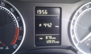

From what I can make out from various other threads I do not have a maxidot display on my 62reg vrs (see pic).
Am I correct in thinking that I cannot retrofit oem Skoda Bluetooth to my bolero as I don't have a maxidot display??

I'm fairly sure everything can be controlled by the Bolero. I'll check mine later (columbus but the phone screen is the same) to see if you can pair phones etc. If you can, I see no reason why you would need maxi-dot.
(And just to confirm, you are correct that your trip computer is not maxodot).

Definitive answer. No you do not need maxidot to fit OEM bluetooth. You will get full functionality from the bolero screen. All maxidot will do is give an extra display on the dashpod and will allow you to control things like the phonebook and call start and end with the stalk switches. Without maxidot you only control the phone with the bolero touchscreen (or voice prompt)
