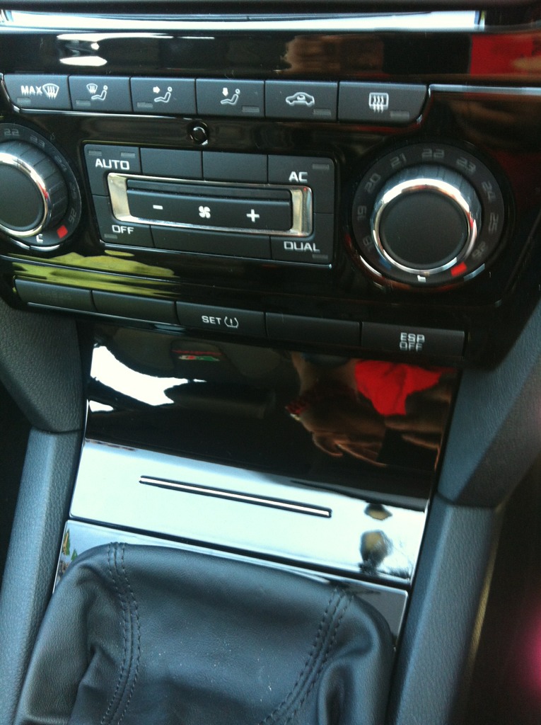

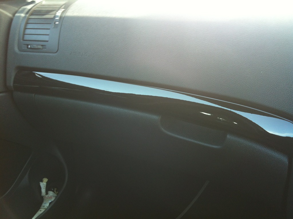

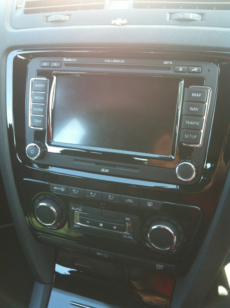

I painted the silver trim on my octy Vrs ltd edition piano black and thought I would post some pics.

It's painted . I did all the prep work wet sanding then laying down 4 coats of white plastic primer then left for three days and wet sanded to a smooooth finish.
The next stage went a wee bit wrong as I was spraying in my garage and it bloomed owing to moisture in air . So wet sanded again and decided to cut my losses and let a pro do the final coats and laquer
