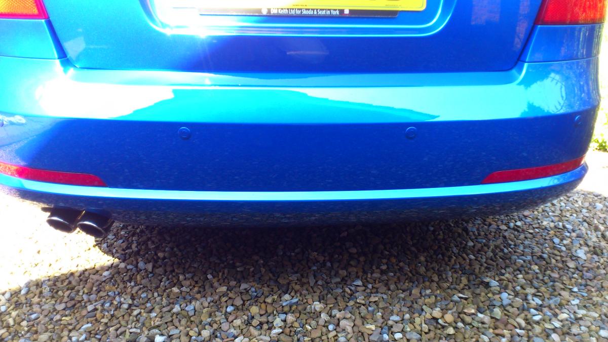

I've fitted one of those £14.50 eBay kits fitted to my octy, works perfect and looks great. No interference with any of the cars systems just wired straight to the reverse light. Had them on for a year now and still perfect, I brought some £12 race blue spray from the dealer to get a perfect colour match.

Dunno mate,the kit he fitted was only about £20 and looked bang on just had to get the sensors painted in race blue which my mate will do for almost nowt :)
After seeing how good the ebay ones look on Xpowers car im going to get a set off ebay & get some paint made up & paint them & fit them myself. Thanks for the replies guys!.  :thumbup:

Fitted my ebay set today,all went well,fitted no problems,total cost was just under £30 inc sensors & getting some paint made up.
Tidy job Mikey :-)

Clive,i found it was easier to remove the bumper on my octy as on the inside of the bumper are 4 circles where skoda fit the sensors so i used these as a ref point to drill & i tied up the sensor wiring inside the rear bumper for a better job,I had some paint made up & painted them myself & the match is spot on.The ebay kit i used came with a hole cutter & all the bits you need.
