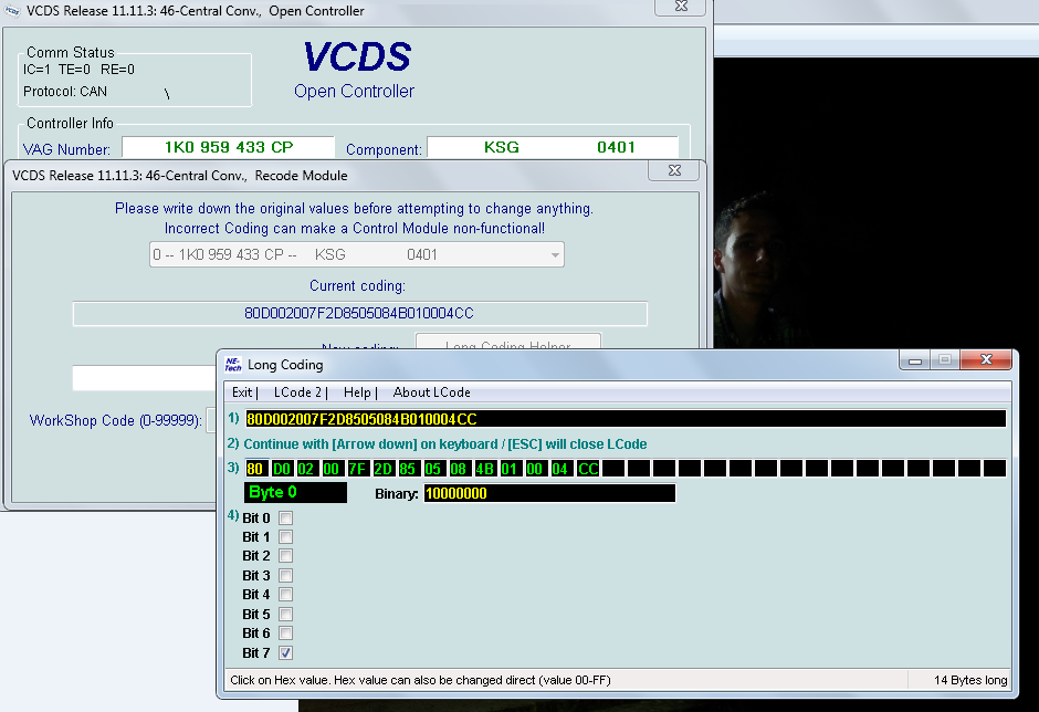

When you have time, can you tell me wich is the exact byte and then bit modification, because to it doesnt show the long coding explications, dont know why although I have both 1K0-959-433-MAX.clb and 1K0-959-433-MIN.clb label files
Unfortunately probably because you have a fake cable.

Blindly ticking boxes that you have no idea what they do can be a very dangerous game and can easily screw up your car.
Giving people Byte and Bit info is all well and good when you have the long code helper to confirm what you are doing, when you are doing it blind they may not activating the same things,
ATEOTD your software is hacked so you could be doing ANYTHING, thats a pretty big risk IMO… but it’s your car.
IIRC Ross tech encrypt the label files etc. to stop other people/software using them. This could be why its not working if your software is hacked.
Sent from my Nexus 4 using Tapatalk 4
Got it. But its very strange that all the modules works and have label files only the engine module (doesent have it at all) and the Central Conv module (have it but dont work on long coding).
If someone has been messing with the software in order to make it work with a fake cable it is perhaps not surprising that the result is not perfect.
