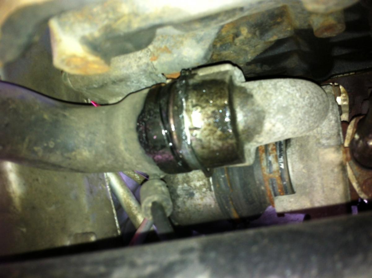

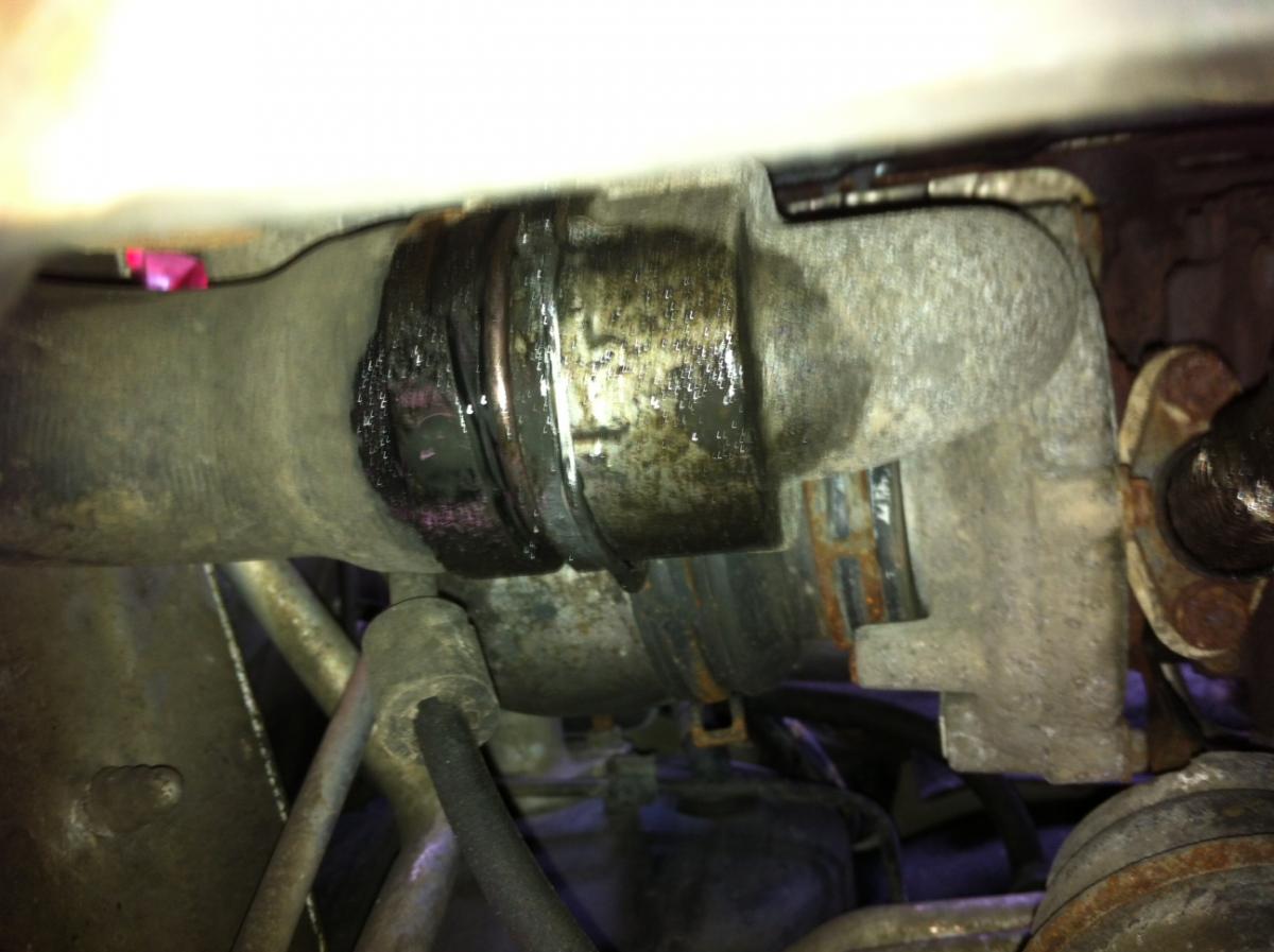

Emissions light is on the dash, comes on every time when I go above 1 bar boost,  also car instantly goes into limp mode..............
I assume the pipe below needs replacing, question is, can I get an uprated one? if so,any recommendations, potential parts and labour cost, direct links to store/ebay/ECP, GSF etc?

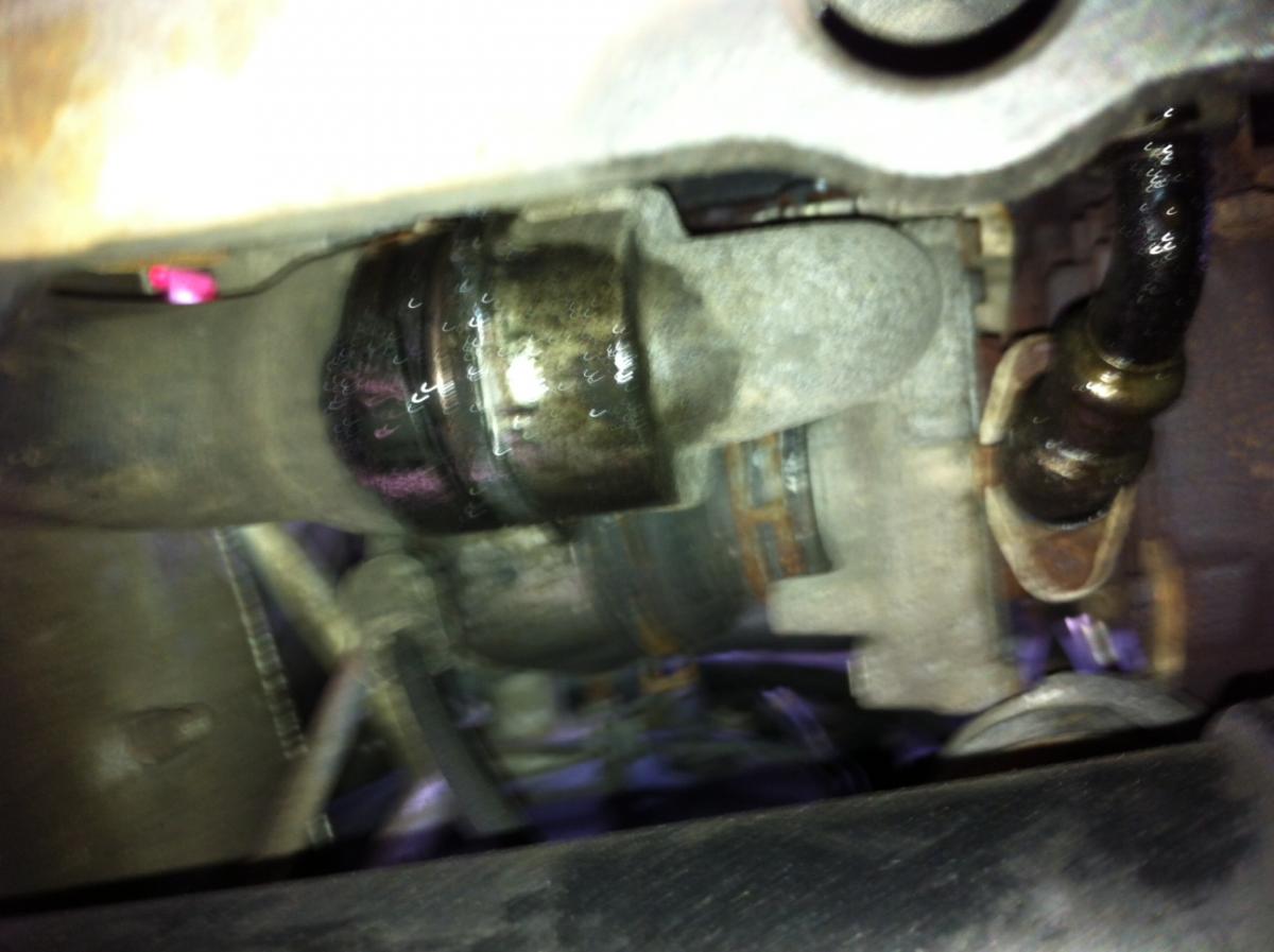

On pic 3, there seems to be another leak? or is it normal for this thin pipe (on the right) to be this shiny?

Looks like o ring in pipe connector is missing
The original pipe has a special end with a boost restricter fitted with a spring clamp.

In the third pic. The leak looks like either the oil return from the turbo to the sump, or the oil feed. I'd get that looked at ASAP.

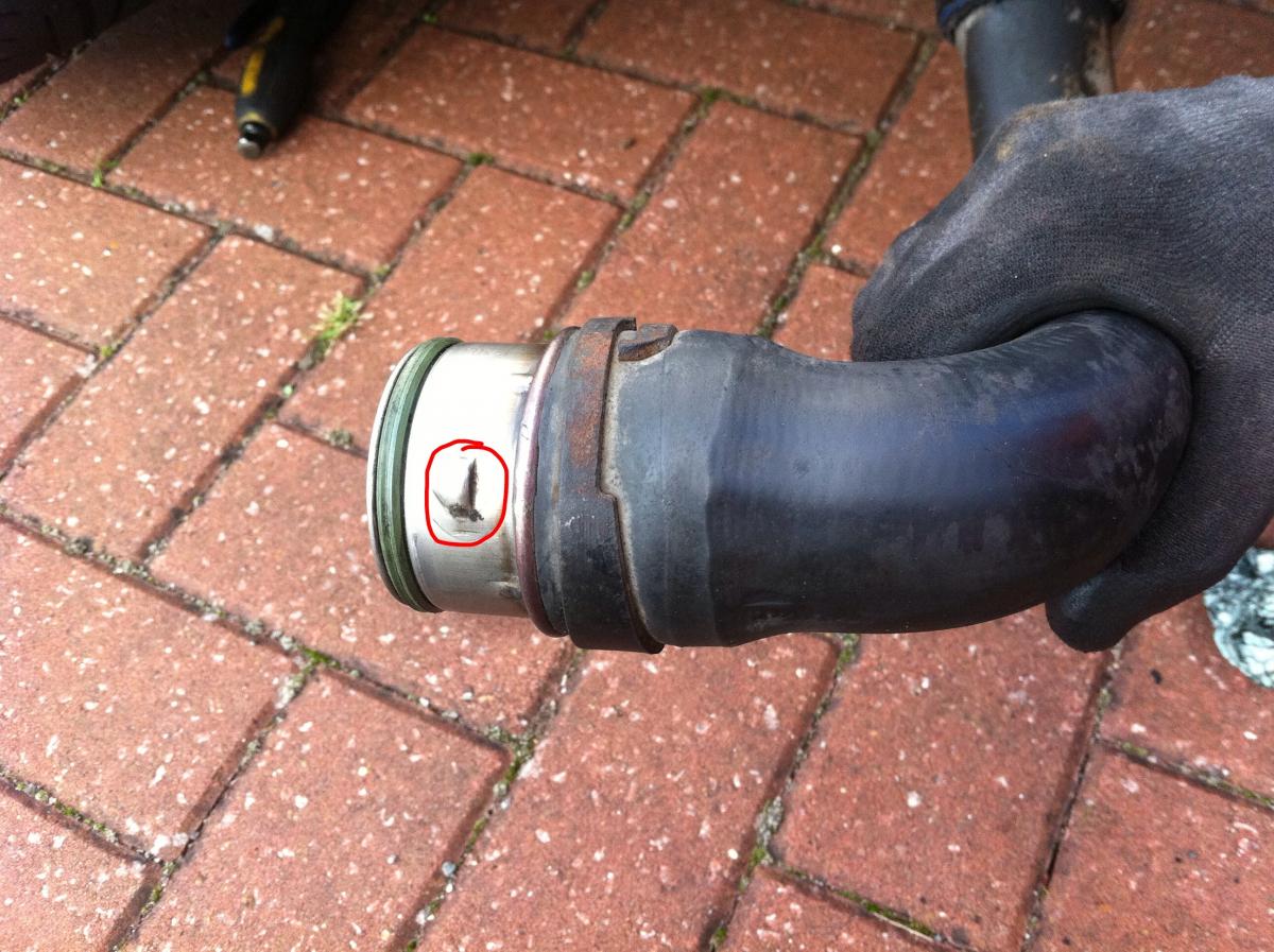

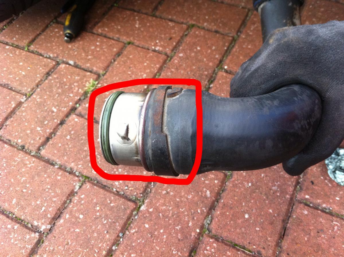

Hi guys, the bit circled in red has a slit! I thinks it's just worn away and now I see where the leak is.
What's the best solution for this?

As I said use self tappers and screw them together - if you get a new skoda replacement it will happen again at some point
Can I just purchase the part highlighted in red, then re-use the remaining pipe work : /
Fair point Dave, I'd rather the get an uprated part if poss to permanently rectify the issue. Also handy for the next buyer of the car when sold : )
