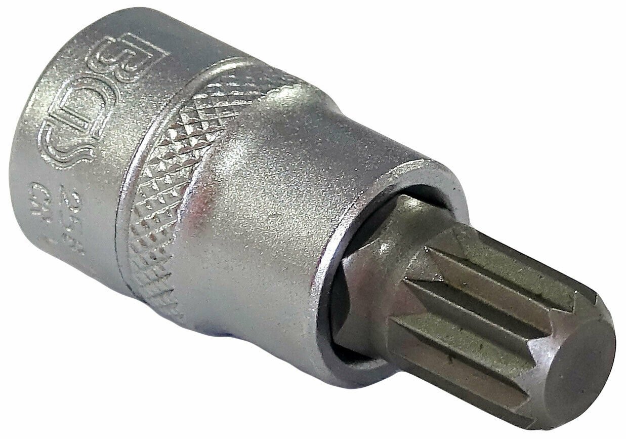

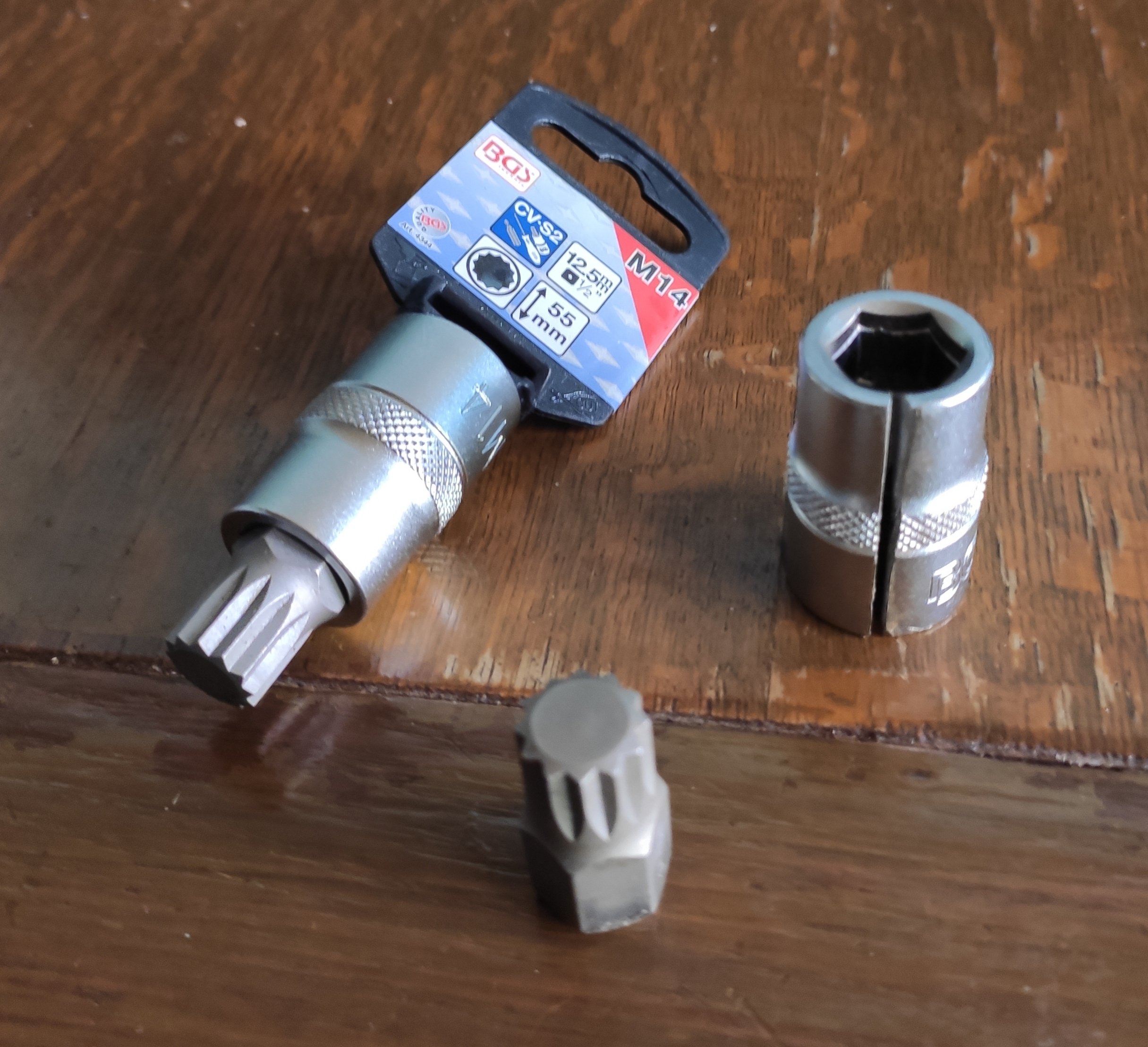

@175GDY can you recall what make your 14mm XZN socket was/is? I just spent 20 mins "tapping" at a BGS socket and couldn't move the XZN bit one mm.
I also have the BGS kit. As long as you can verify the tool is made up of two parts, it will be possible to dismantle.
I always go for a bigger hammer if nothing happens 😁😁
It looks just like that. 3lb ball pein hasn't had any effect.
Managed eventually. tried a gear puller to remove without damage but no dice so cut it with hacksaw until I could wind it out. I bought another as I thought it might come to this....
