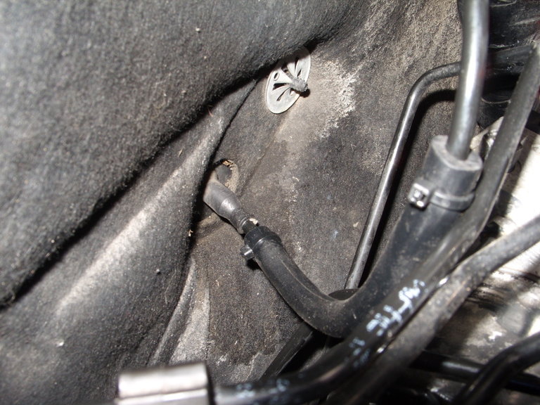

Here's a pic of where I sleeved mine at the bulkhead too. Nice to have no more popping off connectors.
