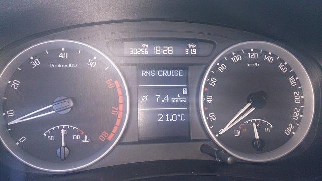

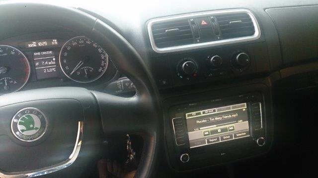

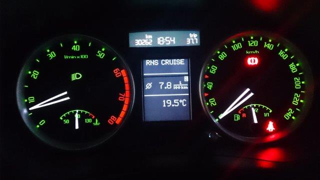

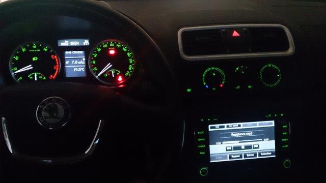

The problem, which i can not resolve - as it shows in the pics attached - is that since day 1, i get on the maxi dot a constant RNS CRUISE logo instead of columbus info (fm station, etc). This 'RNS CRUIS' goes off when i turn off columbus and again goes on, when columbus operates again. No info there whatsoever.
I have read that coding may be nessecary so i went ot my local dealer (Athens Greece) but he could not be of any help as he could not change anythinh via VCDS.
Is there anybody who could share a possible cause and solution to this? I have seen around the web that this is doable to exactly the same setup as mine, so there has to ba a way around it.
