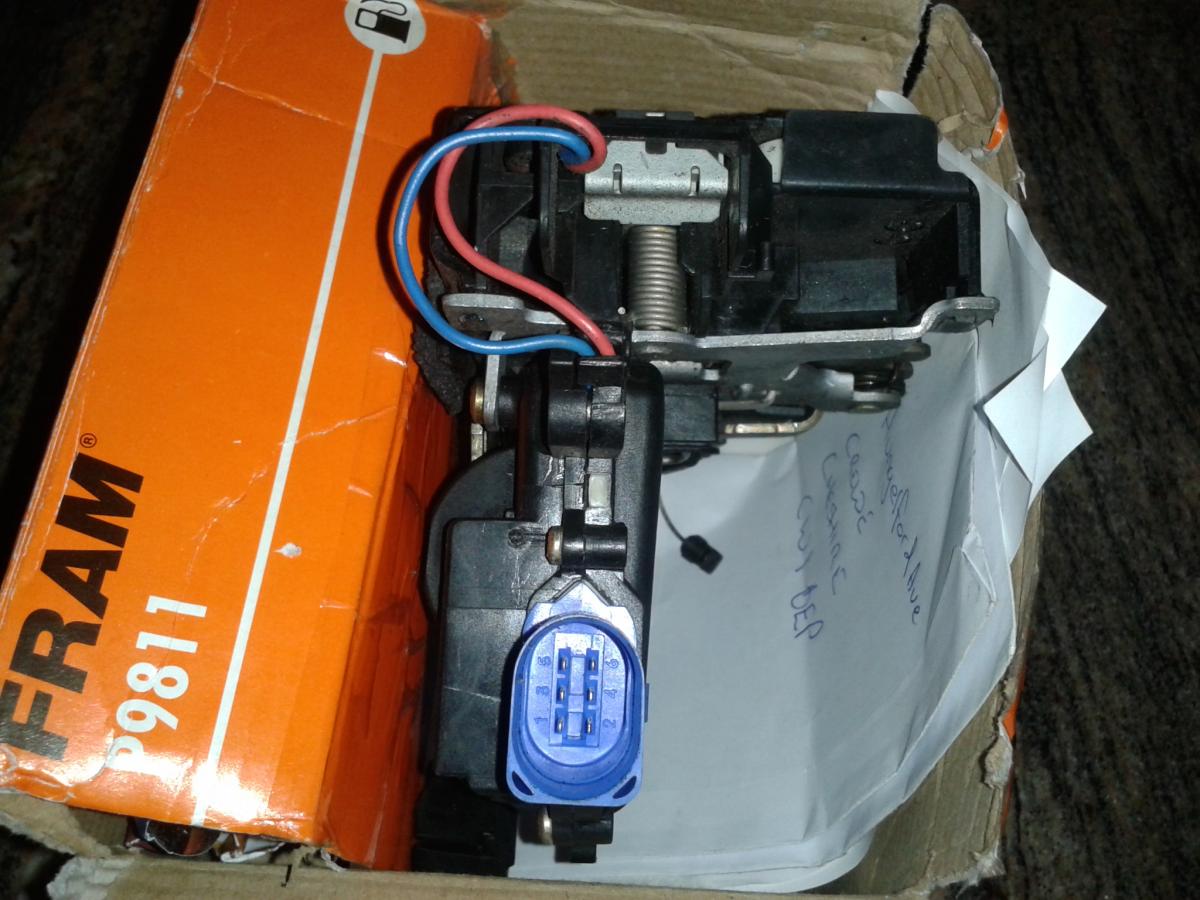

I chiseled my rear to get it open, that was a last resort after applying voltage to check that it was definitely dead. I'll try and post a pic tomorrow of where I hit the rear lock. Once chiseled it opened straight away. I take it you have a replacement to go straight on?

Hi, sorry for the delay.
This is for the rear lock but the front should be similar. The blade of the cold chisel was placed slightly above the blue connector in the centre running from top to bottom, two good whacks with a lump hammer and the door would open.
***this is what worked for me and is my own experience, attempt at your own risk***
