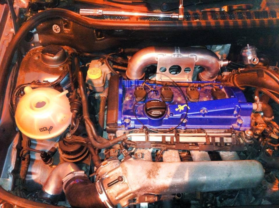

  • That's quite an old engine pic, if people are interested I'll post up some better quality pics ??

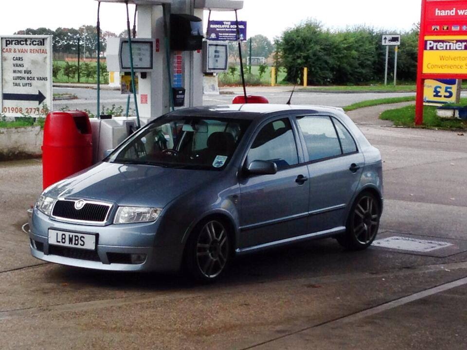

Where's the pictures?
On their Facebook page I think. I'll get some Monday, I didnt think earlier to take any.
+1 I'm interested
+1 I'm interested
+2 I'm interested! :-)

Looks well, the Cupra wheels aint for me though!
What clocks did you use inside?
Standard Fabia clocks, it's all built to work as a factory car, full mfa, full diag and full drive can communication, you could take this car to a dealer and they could talk to it as if it's a standard car, yes ross (techie) is using an engine I sold him lol plus as he is a close friend he also gets any info I've gleaned from this long ass project.
I like this...what a sleeper...
Epic :)
That looks superb!
Sorry by the clocks I meant are there ones from another model that look like the slightly nicer VRS clocks rather than the dull all black ones!
Epic :)
That looks superb!
Nope standard elegance 2.0 clocks ;)
