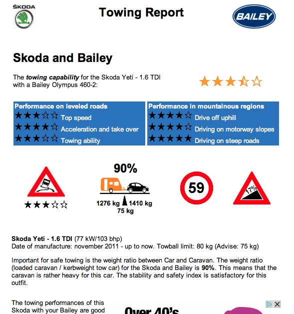

Here it is, put your details in and it will give you some guidance.
LINK
It is quite a close match
Cheers. I've had a look and done a report so it's a decent match.
