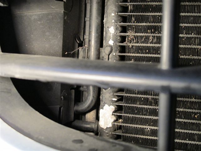

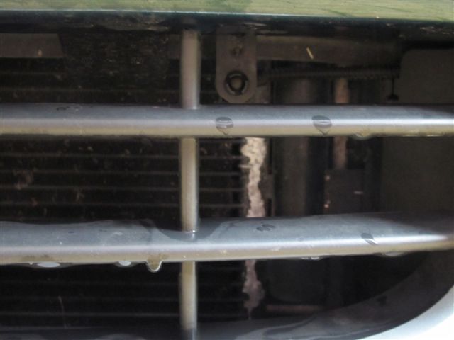

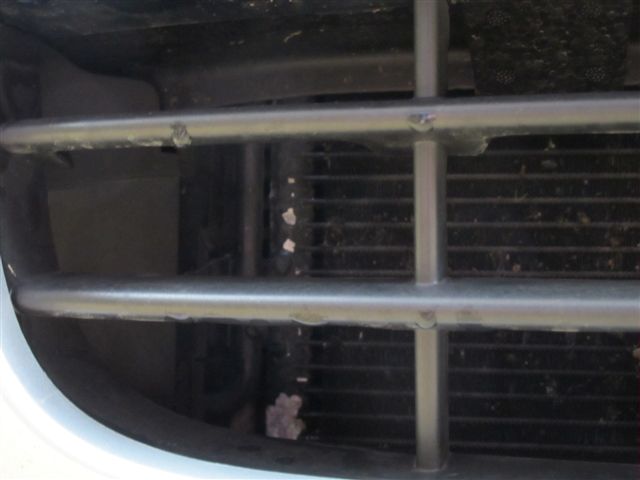

The air con packed up in August jsu as we were going on holiday and loading up the roof rack with bikes.Phoned Robinsons in Norwich and they told us to bring it in the next day to have a look at it.
Could not find a big leak so they re filled up the system and we set off for two weeks holiday in the Lakes with me following on a motorbike. We were told that the condensor at the bottom of the rad was badly corroded and the black paint was peeling off the metalwork in large chunks. Apparently a large batch from Italy had this problem and would be exchanged under warrantty.
Our 2.0 TDI CR SE Yeti had done 24,500 miles at the time of the air con failure. Brought the car back in after our holiday and the wife was taken back to work from the dealer as the exchange had at least three hours labour for the job. Robinsons collected the wife from work and the car had been washed and cleaned very well. Great service from the dealer in Norwich.

Have a few photos of the condensor
