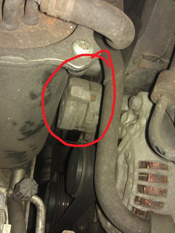

I noticed a judder sound from the engine compartment on idle, intermittent but constant, if you know what I mean, on and off Only noticed it when I started the car to go home from work today, only on idle, when I revved it went.
Got home and listened with the bonet open and it was from the left side, looked around and saw a part attached to the engine was shudering quite violently when the sound occured, I have no idea what the part is or whether it should be doing that.
Have attached image and circled the part that is shuddering.

That looks like the aux belt tensioner.
If it is juddering then either the tensioner is failing or the alternator pulley has failed.

I initially thought mine was making a noise on idle from the same place, turned out to be the DMF!
However, if you can see your tensioner moving and it coincides with the noise, then I doubt it's that same as mine.
