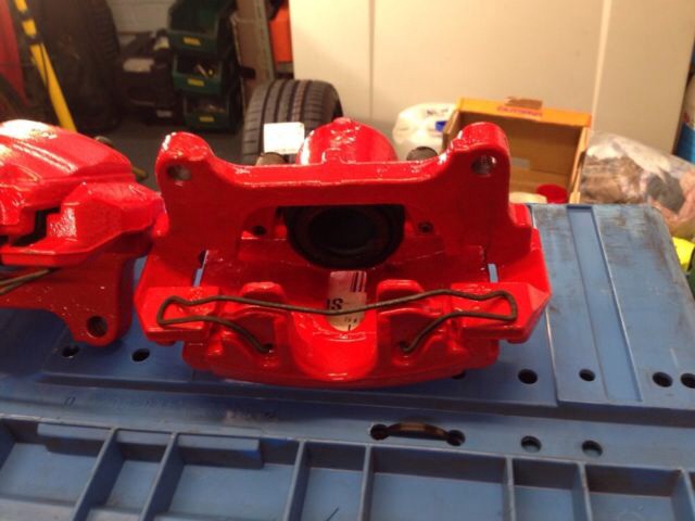

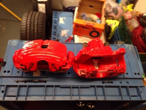

take some pics of the 312 calipers and i will see if they are the same as the ones i have sitting next to me
These are just the pics from ebay where I got them.
I dont think they look like the correct calipers to be honest, im just uploading some pics to compare

If you look a the "hole" in the top of the caliper yours is a different shape

Cheers buddy so looks like I need different calipers or bigger wheels.
they could be the mk2 312s, in which case they won't be right. Just a guess.
I will be selling my entire octavia VRS break setup shortly... got other plans ;)
there off a later 5x112 platform car, thus a mk5 golf, octavia, or ttmk2
+1^^ the red calipers are 5x112 fitment, I was sent a set of them from The TT Shop and they don't come close to fitting.
