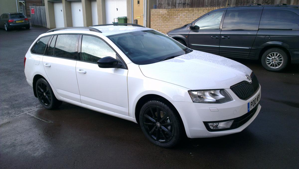

Superskoda mirror caps and grill on my elegance estate...
How difficult is it to retrofit the new frame and is the old silver one glued or screwd in?
Depends if you want to keep the chrome one to refit at a later date. If you do, it would be necessary to drop the front bumper to gain access to the rear of the grill. If not - and I didn't - then it is possible to use a screwdriver or similar object to remove the tabs that hold the grill in place. Takes a bit of force, I used a hammer to persuade them out - but as long as you're careful it's easy enough. Took me about 15 minutes to do mine.
