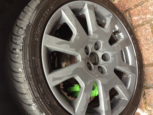

Hi Guys,
Took my car through ARC carwash a while back and it seems to have affected my alloys which had been powdercoated. First port of call was to tee cut them, which did help to a degree, but they are still quite pasty and dull. (Photo was before I tee cutted).post-76551-0-35393500-1383929594_thumb.jpg
Does anyone know what I can do to make them look shiny again please?
I really don't want to have to get them powdercoated again. Are there any options like scotchbriting them and lacquering them? I know powdercoat is a funny substance, so i'd have to be careful what I use on them.

Try some polish and sealer on them..If that doednt work, take them back and ask them to have a look or even do them again
have you used an acidic wheel cleaner? .... a local hand car wash near us uses a acidic alloy wheel cleaner and it looks great for the first few days until wheel nuts etc start to corrode as its eaten the coating off .... possibley something similar happened to yours??
might take a good t cut , polish , wax , seal etc to get them something like they were

Will tee cut start to take the colour away though?
Yeah most probably acid has done it or something they've used at arc.
Does anyone know if lacquering them would do it? Or would it give a poor finish and not take to the powdercoat?

Will give another tee cut and good polish and see what they look like, failing that I will look at other options, either taking them back to powdercoaters or lacquering ?
Aghhh!!!.........Ditch the T Cut idea..its deadfully harsh stuff and not recommended !!!
Just a light polish (AGSRP if youve nothing else), then sealer will do

Were the wheels in perfect condition before the car wash? Or were they not as bad? depending on how long they were coated, it could be that the powder coating company in question used polyester instead of epoxy poly. Epoxy polyester coatings are for internal and polyester are used for external use. You may get away with applying a lacquer, after using T cut lightly on them.
 Some sealers may react so try a bit on the inner section first

As I recall yes, I wash the car mainly every week, only using turtle wax nano tech wash and a week before they were fine.
When I wipe the alloy over with a wet cloth the colour goes back to the original anthricite look, then when it drys it goes back to a light grey' pasty look.
So do you think normal auto lacquer would stick to the powdercoat ok?
Rattle can lacquer from an auto factor will work fine only if the wheels are one uniform colour. If they are blotchy, they will gloss up just the same.... blotchy.
Going by the picture, if that`s them dry then lacquer will not work. It looks like sections have been gone over with a scotch pad or something abrasive dulling sections, in which case they will need re coating
1500 wet and dry complete alloy
Then 2/3 coats of laquer
You need to take it to the powder coaters for them to have a look before you touch them.
Now they just look completely dull, not really any shiney bits so may be ok to try
I will take them to a powdercoaters to get their opinion before I go ahead and do anything Chris.
I appreciate all the help and info everyone has given me, gives me good backup for when I do see the powdercoaters and what I do decide to do with them.

Before doing anything to them I would talk to the company who done them and see if they can suggest the best products to use. Talk to the professionals before asking on here.

You need to seek out what cleaning products the car wash firm used. It would seem to me the acid used in the product hasn't been watered down correctly. Having been in the trade for 8 years to me it is the fault of the car wash firm. The only time powder coated items turn milky white and cloudy, is when they haven't used the correct poly powder, this takes weeks of exposure to sunlight.
 As above, a rattle can of lacquer and heat, will make the finish better, as long as you are confident in your own ability
Yeah, annoyingly I have left it too late to approach the car wash company :( I thought someone had splashed brake fluid on it at first not the car wash
