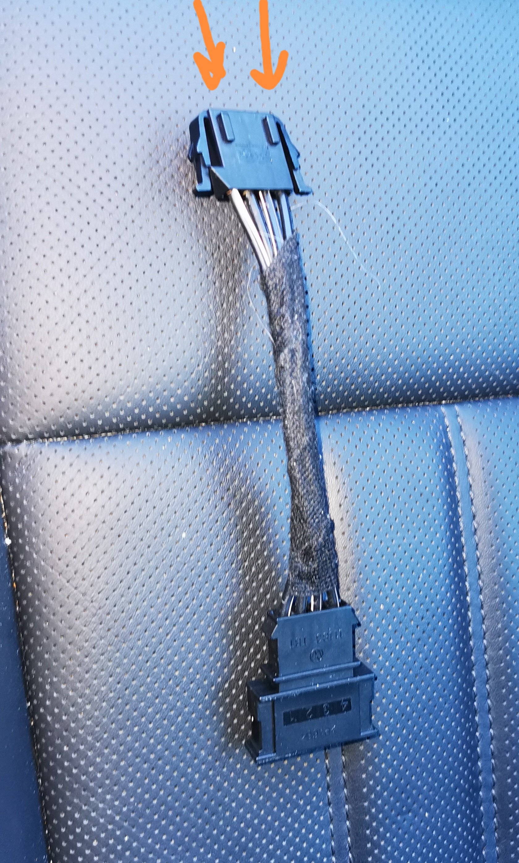

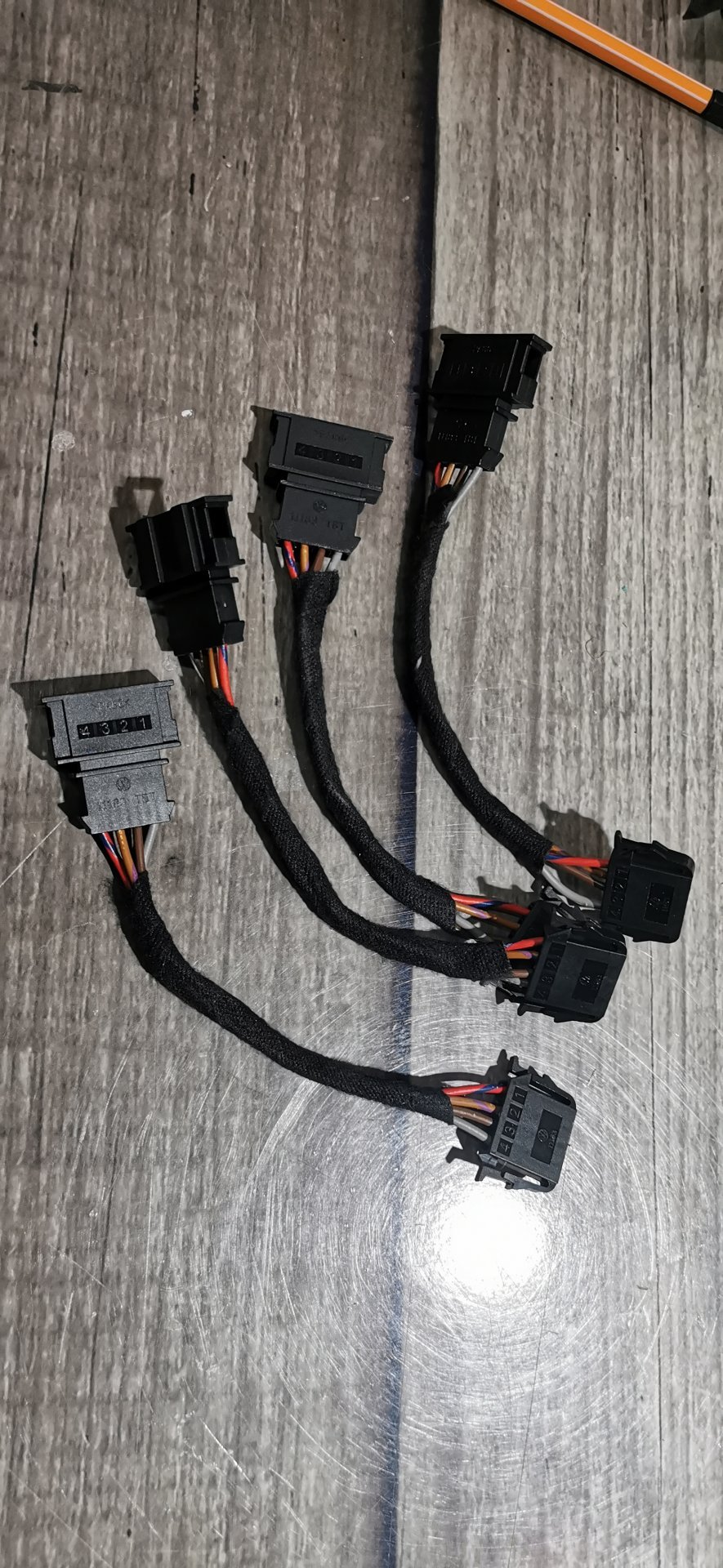

Hey Rich,
plug and play solution  - 2 minutes, no effort, no risk, fully reversible.
chopping off the noses  - 10 minutes, some effort, risk of cutting your fingers :D
opening the connector and reverse the order of the wires - with proper tool - 10 minutes, without - 1 hour of trying with needle. risk of messing it up with the order. but doable.
No need to know anything in electronics. Just follow the scheme.
those are the noses which have to be removed in order to be able to turn the plug

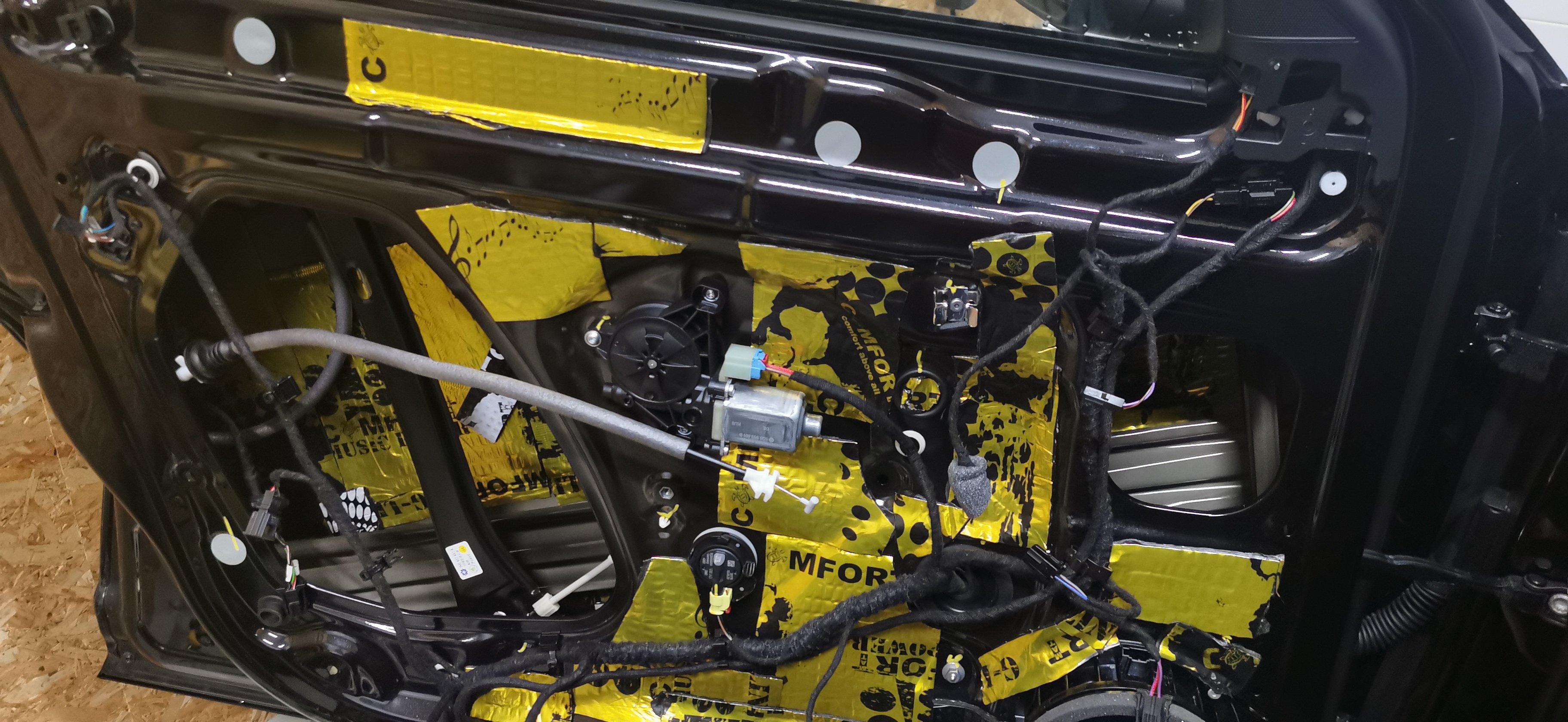

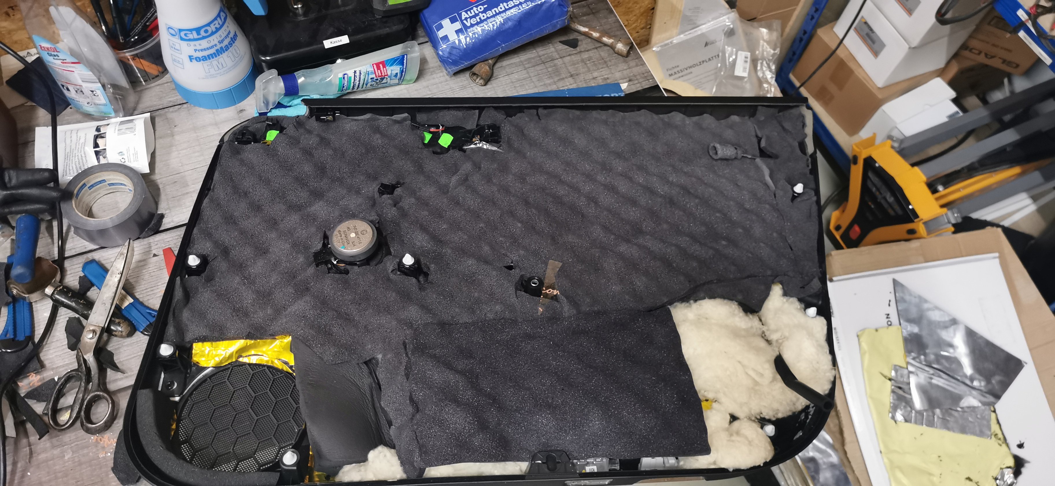

no rattles or squeaks, but I already fully soundproofed the doors, the luggage compartnent, the bonnet and the wheel arches.
without this Superb is definitely one of the louder cars in segment

after some delay the snake oil magic cable arrived by @Richmix
May be he'll share his magic voodoo experience? 🤭
  • 4 weeks later...
I also took a punt and, while I'm not as blown away as Richmix, there is a definite improvement in the overall sound quality.  The sound is richer and warmer, with more detail across the sound spectrum.  Thanks to @spacelord for the discovery and advice.

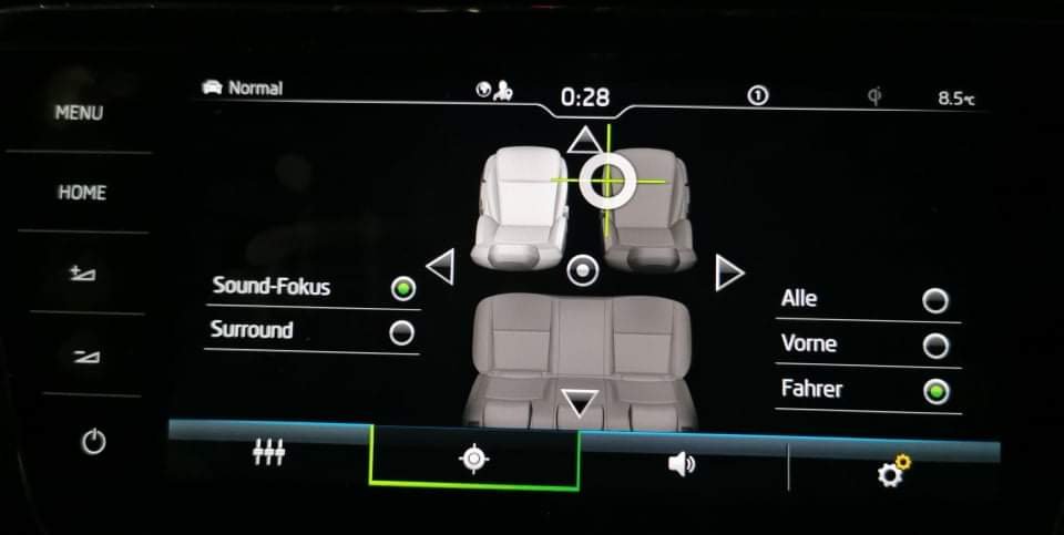

I realized that you guys sit on the wrong side 😅🤭for that reason the fader hast to be put a tick more to the left instead of to the right, as in my screenshot in the original posting.
On 28/04/2022 at 16:30, spacelord said:
Best bass performance is achieved when setting focus to driver and fader moved to the front and one click to the right.
