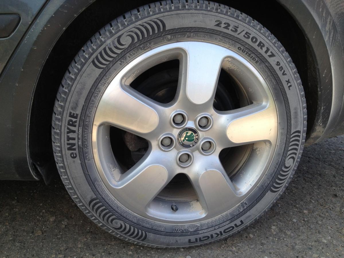

Started out with the standard Dunlops on my Scout which were OK in Summer but hopeless in winter. Last few years I've had Maloya Swiss winter tyres which performed well and I ran them into the summer this year because the Nokien eNTyres (all season) which I'd replaced the Dunlops with are hopeless in the wet. The Nokiens went back on for the summer as I had some high speed driving across Germany and they performed well on dry gravel in Latvia. This winter I'm running Avon Ice Touring which I am very pleased with on damp, wet and leaf strewn muddy country roads.

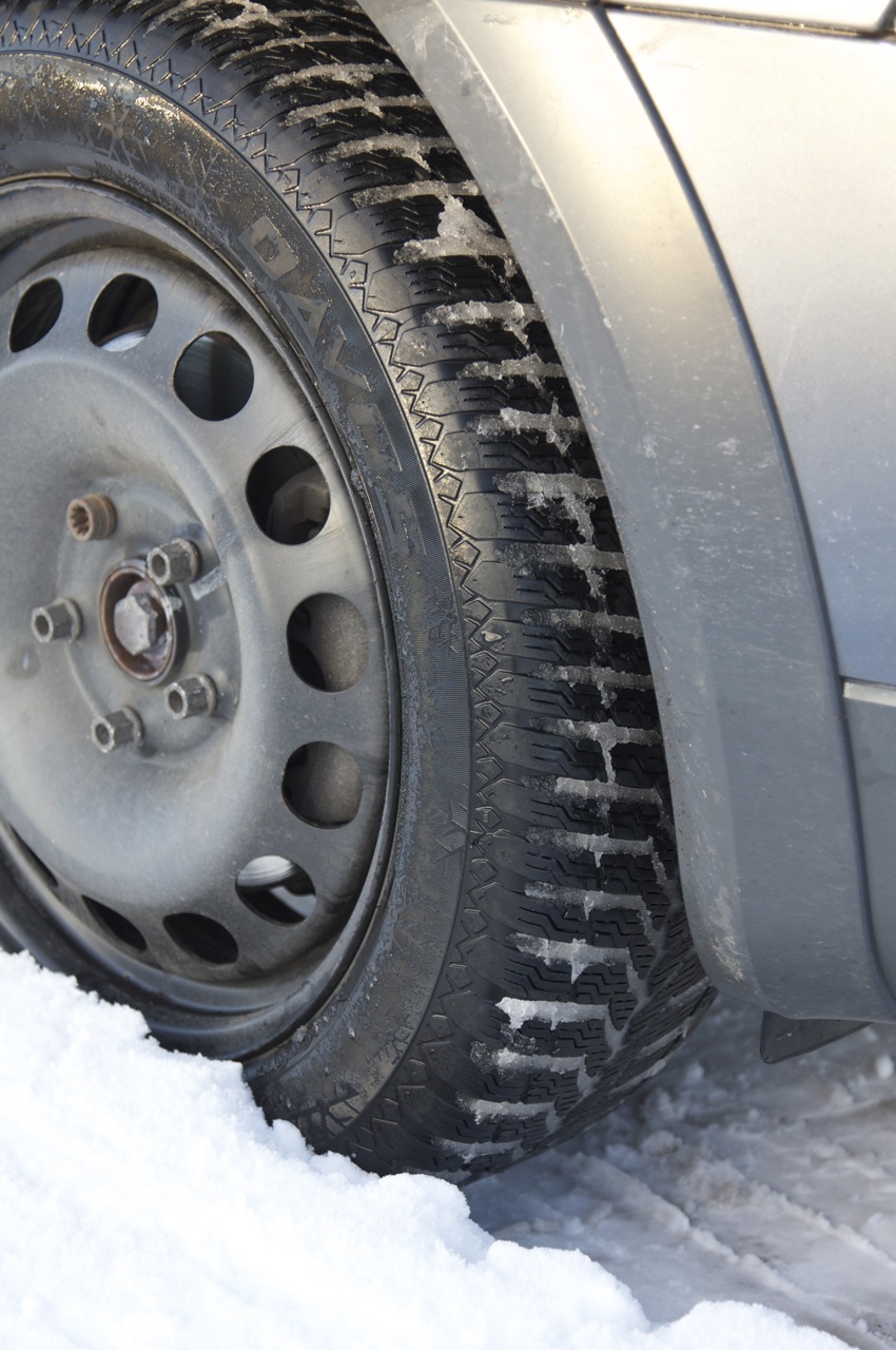

Second year for me with Good Year ultra grip 8s on 17" winter wheels on the VRS cr.
Work well for me - better traction on the 2 wd Vrs than some of my gliding colleagues on the wet muddy airfield were getting in their 4wds.

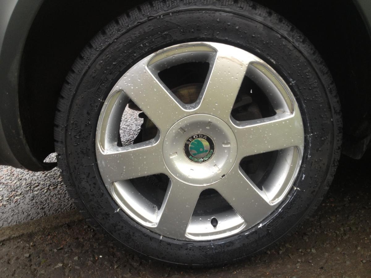

My Octy now has Avon winter tyres on.
