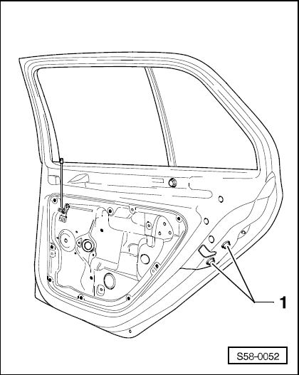

A photo of the mech would be great, as there is nothing I can find on Google or in my manual.

Now I've not took my fabias door card off but when I've had this on previous cars the rod hooks into a hole and the plastic clips around it to hold it in place
That ^ IIRC the long end with the weight points down and you hook the rod into the left/ right side depending on which door side.post-73816-0-24524400-1385062751_thumb.png Not the best pic but it should give you an idea.

Forgot to mention this is the front door.
Cant see anything that relates to weights.
