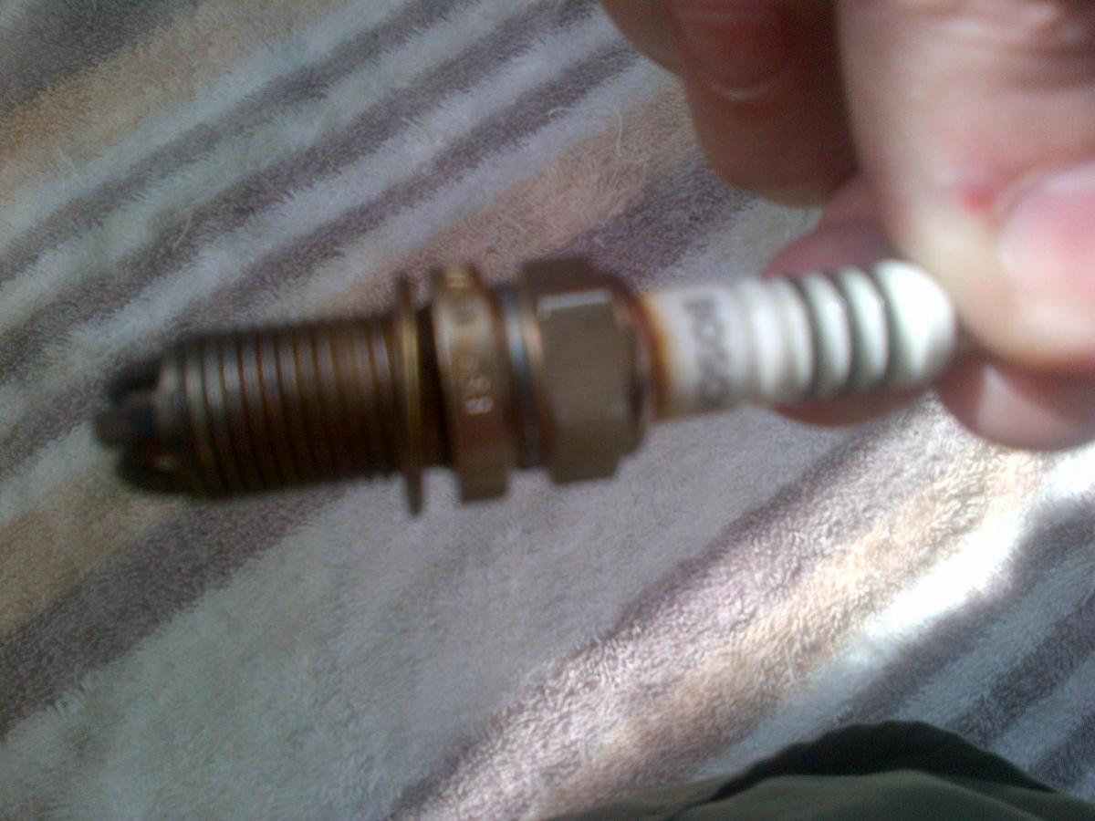

He toll me that the correct Spark Plugs for my car are: 101-000-051AA. So I went to my car, and took out the spark plug that is close to the timing belt area and to my surprise the spark plug was a 101-000-051AA made by Bosh part No. F7LTCR and the Skoda dealer are the ones that do my maintenance, so they put does plugs at the 40,000kms maintenance
Things I notice on the removed spark plug:

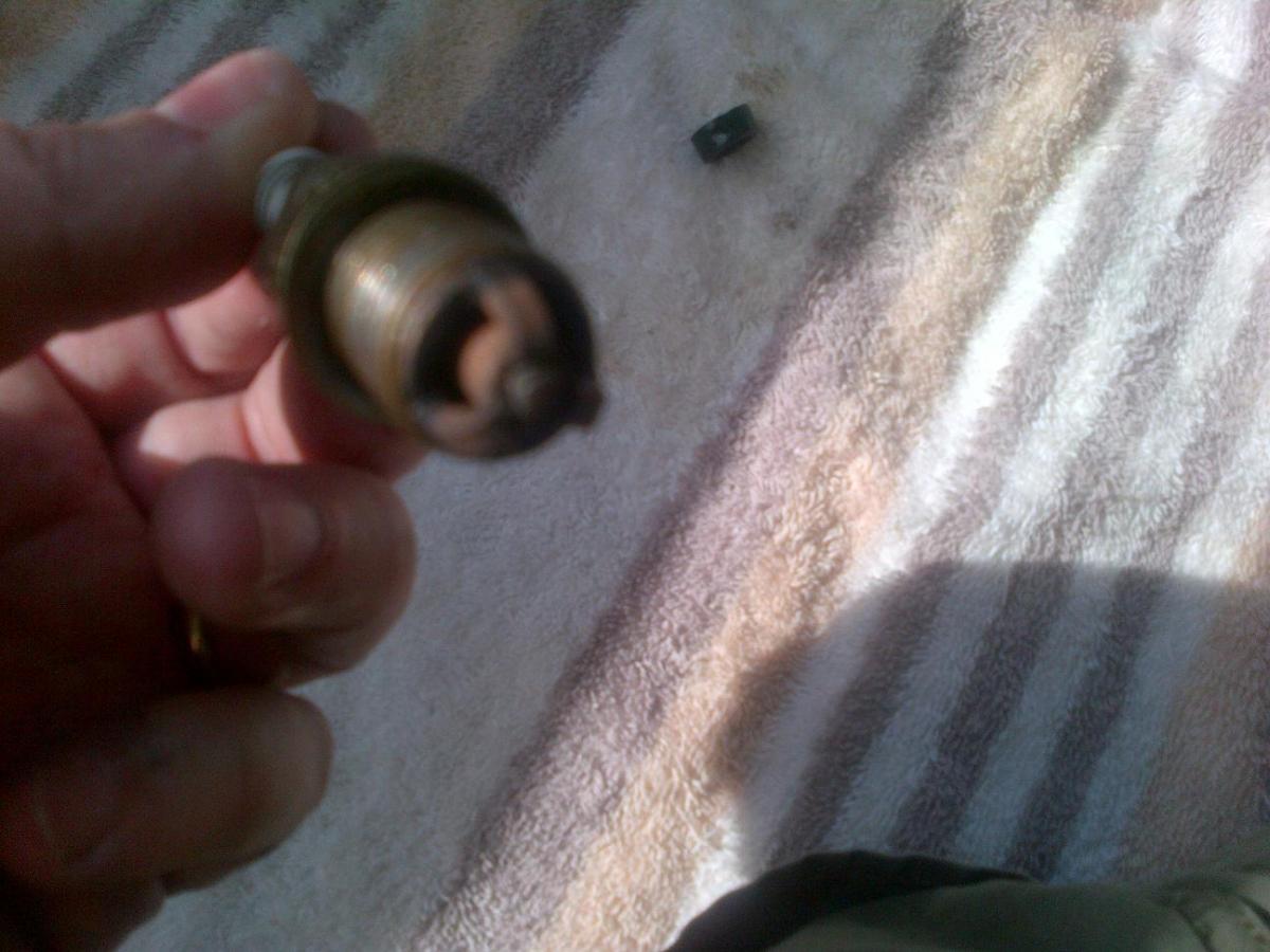

1) The spark plug was cover with engine oil, inclusive the treaded part was also cover with engine oil. I cleaned with a towel and its look like the color/combustion is OK. Electrode looks like new. I am pretty sure this plugs has like 20,000 kms. (Car has right now 60,000kms.) Please check the my plug pic.
My last engine oil change was 5,000 kms ago and I check it today, and I need to top it with 1/2 quart. Usually I have never has to add oil between changes. Always use Castrol Synthetic 0W-30 the one thats is made in Germany and change it every 7,500kms
So do the oil on the plug is a normal thing? Do I need to worry about? Any advise? Do I need to change to 0W-40 or 5W-40 oil?

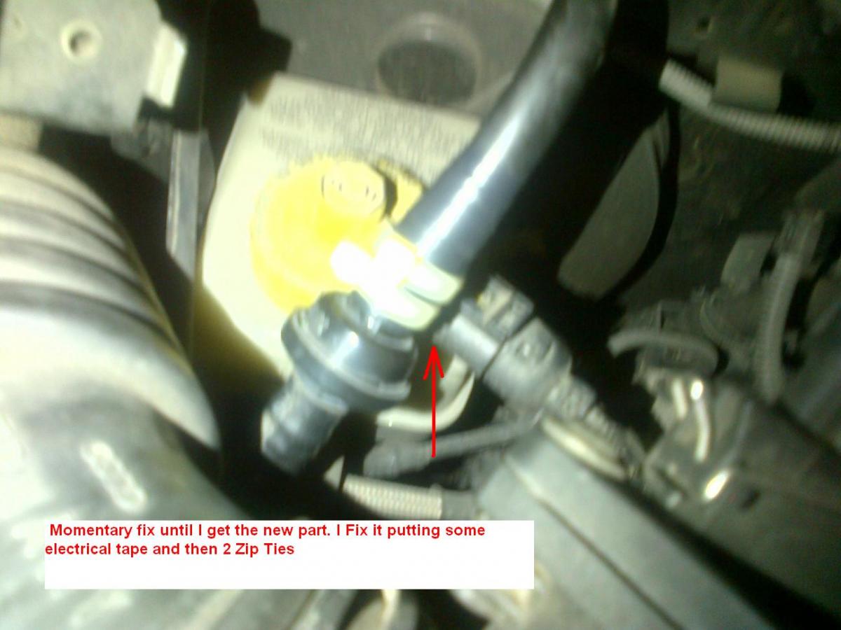

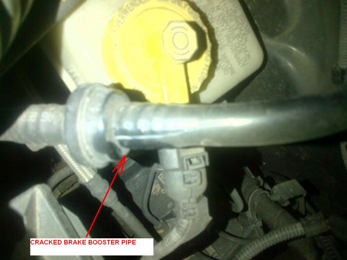

2) I also found a cracked brake booster pipe were it attach to a check valve. Car was breaking OK and I never notice the brake pedal was harder to press but I am pretty sure that it was loosing vacum in that part. I started the engine and can hear the sssssssss air noise. Skoda dealer have the part in back order for me so I fix it with electrical tape and some plastic zip tie.
Can this vacum loss can make my engine consuming more gasoline?

The reason you have oil on your spark plugs is because your cam cover internal gasket is leaking. The cam cover has 2 gaskets , the large outer one that runs around the main cam cover and the inner one that has 4 rings in it that sit around the spark plug holes . When the inner one goes hard it starts to leak oil down the plug holes that sits on top of plugs. This is also your reason for loosing some oil.

Wow. Lots of questions there! You don't actually say what mpg your getting so its difficult to answer. Mine isn't great round town maybe mid to late twenties. Your plugs look a good colour. If oil was on the electrelode part I don't think that's great news but I don't know if your saying it was. If it was just the threads and top part check if the well around the plug has oil in it. My rocker cover gasket was leaking into there so that could explain the oil usage, although I'm not entirely sure your using the right oil. I thought 5w30 long life or 10w40 was for the 1.8t engines. I'm still not sure about Bosch plugs either I would go with NGK.

Wow. Lots of questions there! You don't actually say what mpg your getting so its difficult to answer. Mine isn't great round town maybe mid to late twenties. Your plugs look a good colour. If oil was on the electrode part I don't think that's great news but I don't know if your saying it was. If it was just the threads and top part check if the well around the plug has oil in it. My rocker cover gasket was leaking into there so that could explain the oil usage, although I'm not entirely sure your using the right oil. I thought 5w30 long life or 10w40 was for the 1.8t engines. I'm still not sure about Bosch plugs either I would go with NGK.
Hey Meaty101, I know that driving in the city I make like 350 kms with a full tank, I am getting like 250kms with a full tank, so something is wrong.  I will check this next full tank is the temporary fix I made to the brake booster pipe help in my fuel consumption.
The oil was on the treaded part of the plug. Thats why I was like :think:
Regarding the BOSH brand, this plug is a factory VAG part number 101-000-051AA. This number was in the plug. Also on the white ceramic part of the plug was stamped BOSH and on the other side was stamped the Audi logo and there was also the Bosh reference F7LTCR. So its look like not only NGK made VAG plugs
