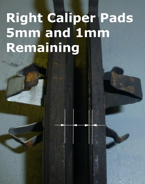

It was the right hand side that wore quicker for me - by a lot too - and I really cant say why that might be. Click on the picture below of the right hand pads with the outer one beginning to score but with 5mm still on the inner one...

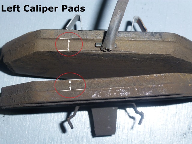

And below are the left side pair both quite even and still with considerable meat. Note the sensor is on the left side set only and on the inner (piston) pad...

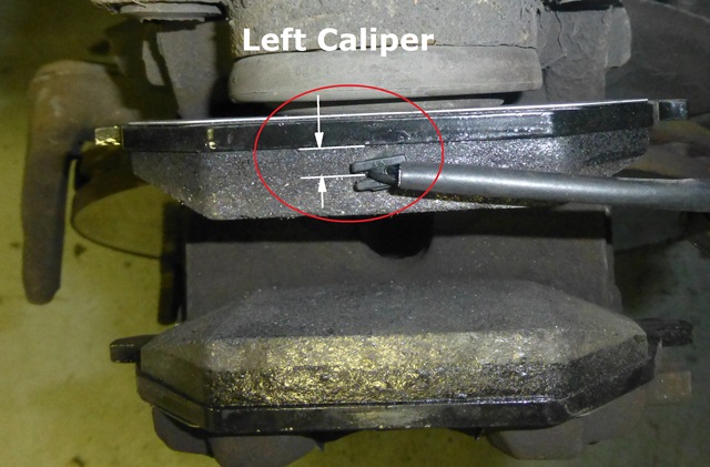

Below is the new set sitting into the left hand caliper - but why is the sensor wiring entering the pad at that distance away from the metal back plate - isn't the disk going to eat into it way before it is nearly worn...

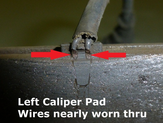

Just like it did below on the old one even though there's plenty of meat left...
So it leaves me wondering firstly as to why the wires do not enter the pad perhaps from behind the and perpendicular to the back plate and maybe penetrating into the brake material by a couple of mm and secondly why there is no sensor on the right hand wheel also - how much more would it have cost?
Also - I'm wondering that even if the above was the case it still wouldn't have given me any sensory type warning as it was the outer pad that wore to the back plate rather than the inner pad. I think there's something weird on my car that that one pad alone wore to 1mm whilst all the others were about 5mm?
