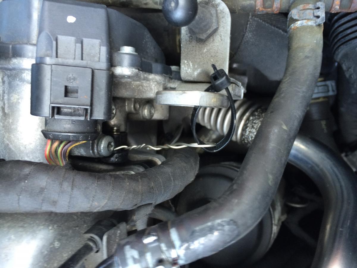

I have had the same fault on my 2008 TDI Vrs
After much messing around I found it was just wear causing the motor to over open the flap on shutdown.
For info lever forward = flap closed

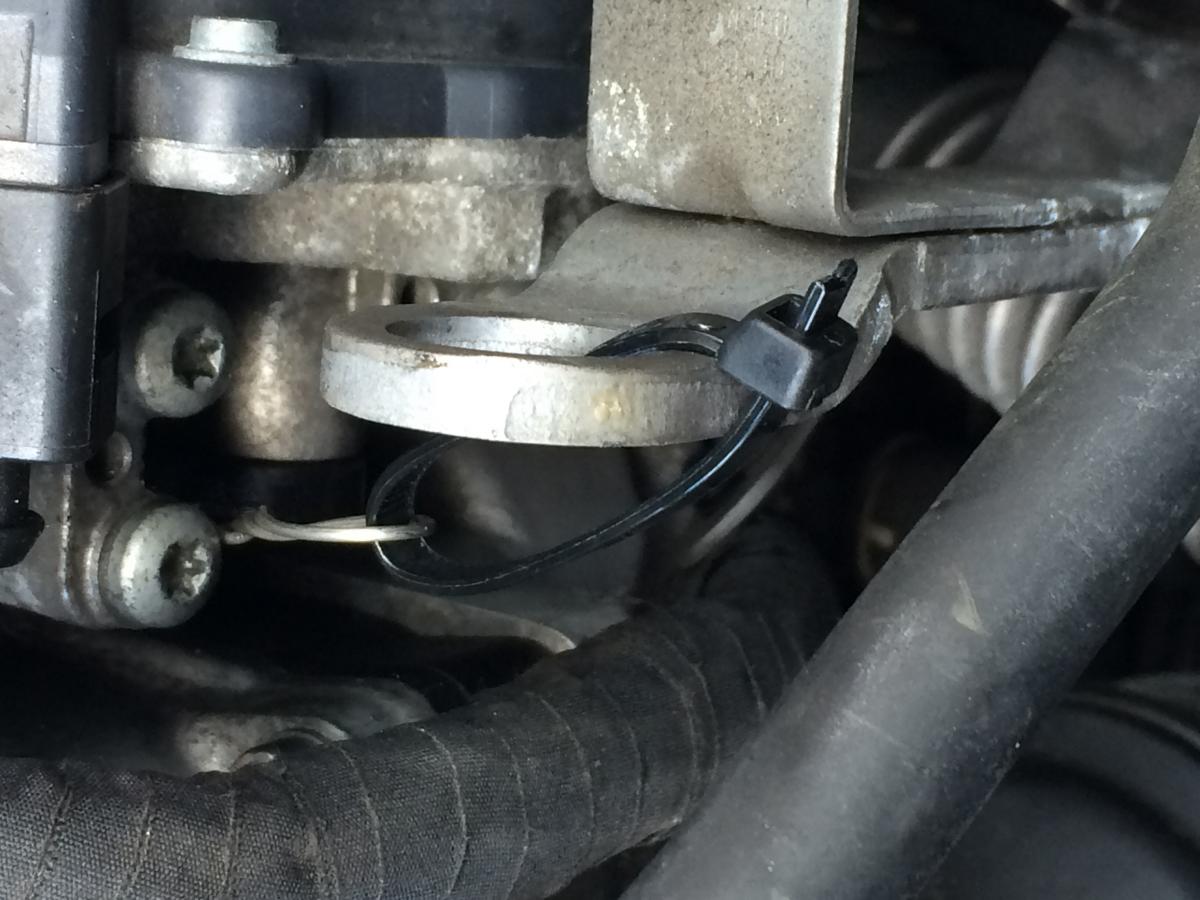

I have used a simple modification which has proved successful over 3 weeks.
I tied some lock wire around the lever and attached it to the hoist bracket with a tie wrap and then tightened just enough to prevent over opening.
I am intending to fit a stop bolt or block eventually.
Diesel Geek in the USA have found the same and are selling machined stop blocks.
I have attached some pictures
