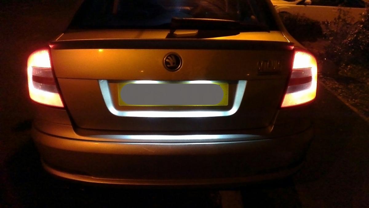

Do they cast a nice, white light or does it have a blue tint? My number plate LEDs are a bit on the blue side and I'd like some white sidelights.

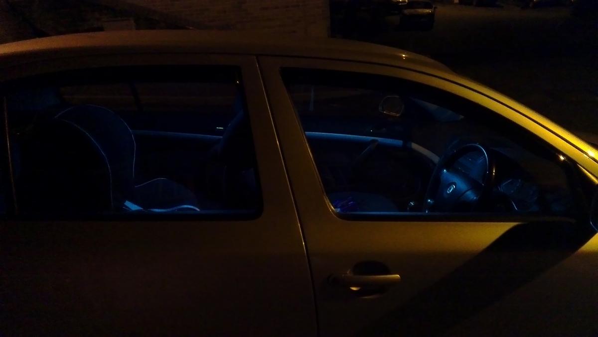

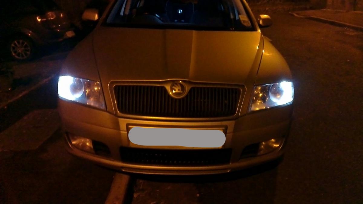

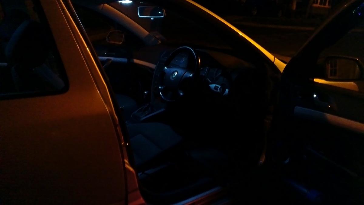

Some pics but they are not great as they don't truly do the LED's justice!
Edited by billywhiz040480
None of the interior lights, nor the puddle lights *need* to be CANBus friendly. They're not part of the error-reporting system. My current puddle-lights are certainly not CANBus friendly, but do cast a nice Skoda logo onto the ground ;)

The other thing I noticed was if the front ones are too bright, they can drown out the indicators.
They are all Xenon white I don't think there's anything blue about them. Maybe the front side lights might look a little blue but compared to my 5000k white xenon HID's but that's all.

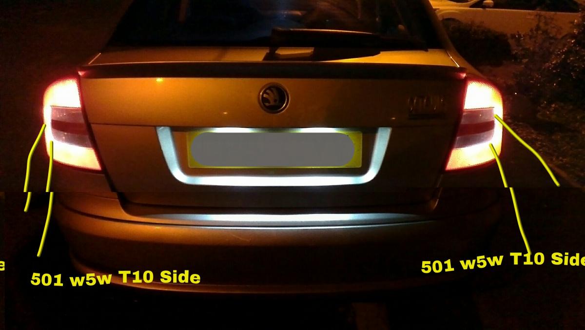

All my interior lights are non canbus. Really liking the parks though. Are there four parking lights to the rear? I know of the two at the front!
Two 501's either side.
