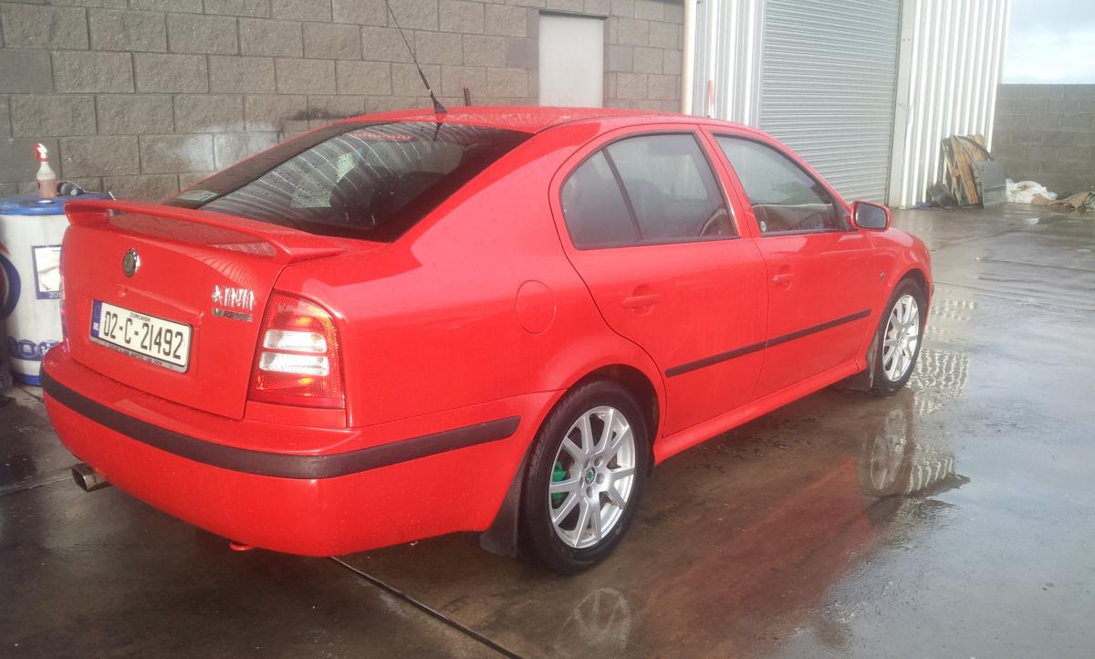

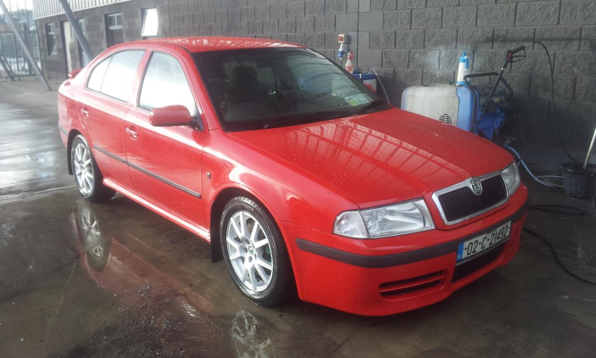

Here she is freshly painted.
New badges and center caps for the wheels aswel
