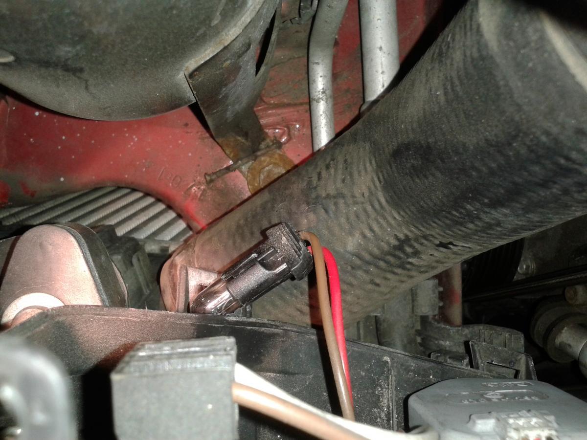

I there any body no any tips on replacing the bulbs, In the manual it says to pull on the wire part .but that dont work .? :-(
fronts or rears? Rears unclip and then twist the bulb.Fronts are a little more difficult, especially the passengers side due to the battery location.
Unclip the cover on the rear of the lamp unit, the sidelight bulbs have a black plastic housing that two wires go into DO NOT PULL THE WIRES,  the black housing has ttwo little 'grab holds', pull out with these and change bulbs.
Hopefully you can see in the picture the tabs I mean. Grab each side between forefinger and thumb and pull out the holder
Cheers will try in the morning.
