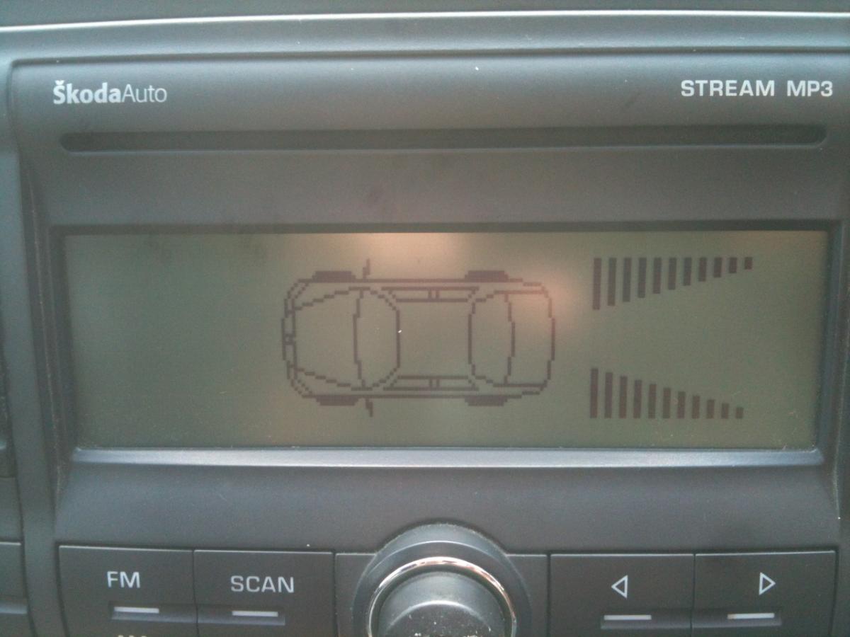

Sorry to hijack the thread but I'm curious.
My 06 L&K has rear parking sensors with a crude display on the Stream screen.
Does anyone know if front sensors are easily added to the system?
Not easily, but they can be.

J306TD: For it to work on a Columbus in your car you will need to follow the guide I linked to above. I suspect the thing cheezemonkhai is referring to is related to the much more basic Stream stereo display (which works with the older module you currently have).
cheezemonkhai: Correct me if I am wrong though.

Here's the Stream MP3 graphics showing rear sensors active, but the front are the same.
