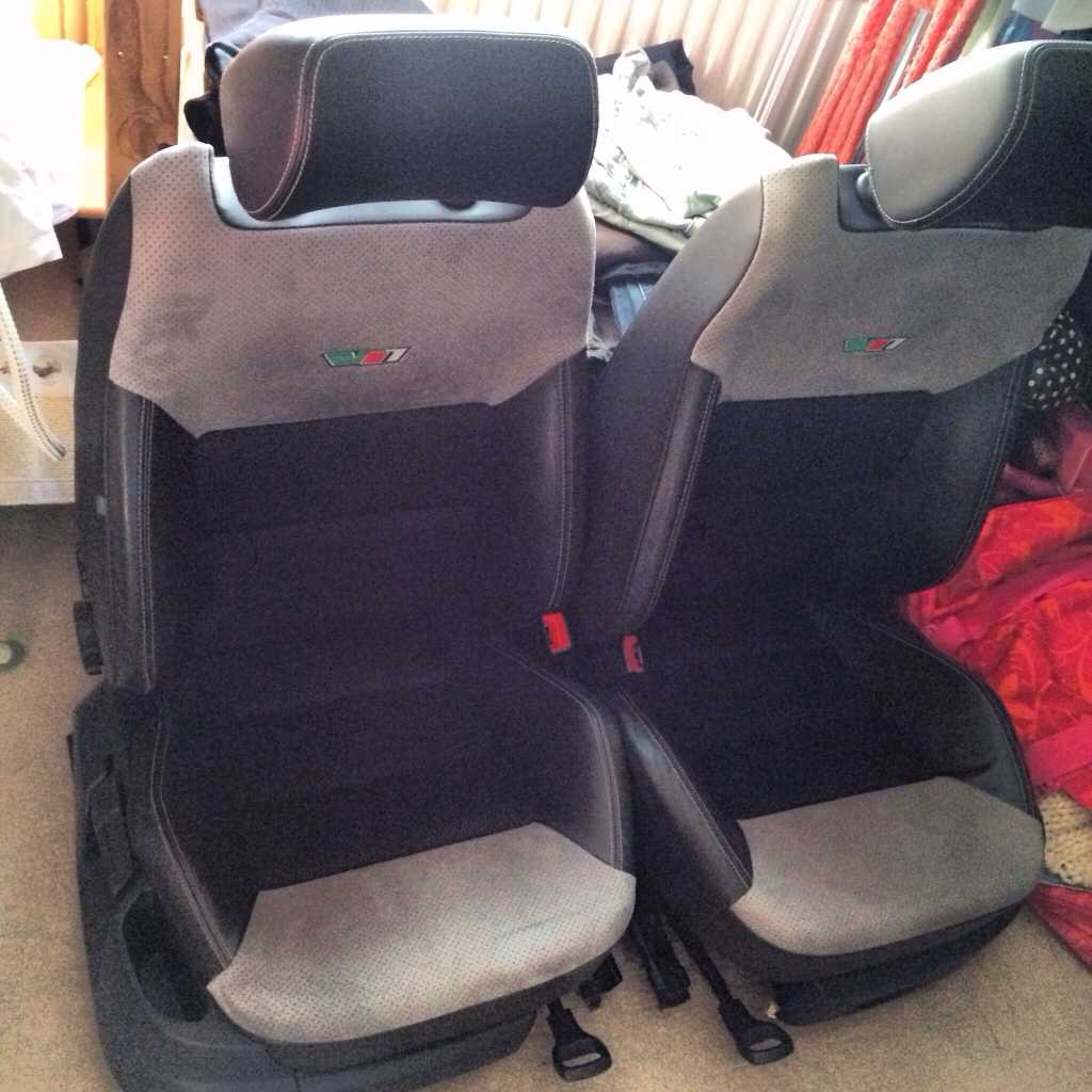

Bought the octavia vRS mk2 seats I'm guessing they won't be a straight fit but has anyone ever tried? post-102182-13874574364175_thumb.jpg

As far as I know theres not been a mk2 to Fabia mk1 conversion yet.
However I can't see it being that different to the Recaro/Octavia Half leather Fabia swaps that I, and others, have done.
You'll just need to deconstruct everything and see if the bottom of the Octavia seat base foam matches the Fabia meta work, if not you may be able to trim and/or add to get a decent flush match.
More importantly will be checking that the back rest is the same size and position to be able to bolt it to the Fabia metal work.
If not it'll be a case of modifying the Octavia metal work to fit the Fabia frames in the car, or modifying the frames in the car to match the Octavia metal work.

Looking at them they have runners either side like the fabia so they could just bolt in with some custom brackets. They might be wider than the fabia though and physically wont go in the space the fabia seats where in. The way pasty done his recaros is pretty simple though if the runners cant be modified to fit.

It's a simple enough process to do.
Take off all the plastic trim, then undo the massive bolts holding the back rest on, do the same with the Fabia one and then marry the two up, to see if octy will bolt to Fabia base
I know my Golf ones and Octavia mk1 ones were exactly the same width.
If you hit problems at this point things'll get a bit more complicated.

Also i know dav_vrs and jason (devontopia) have fitted golf mk5 seats in and they are the same platform as the octavia ii. Be worth giving jason a pm as he is on her more than dav i think.

I'm pretty sure Jay went down the route of custom mounts and amendments to the shell of his car - i.e. drilling new holes in the floor - to get his to fit.
Anything is possible it's just how revertable you want it.

I imagine it should be very similar to Pasty - any my recent remock attempt of this following his steps.
Fronts should be straight forward enough and come out perfect, as mentioned about dismantling and matching with the donor bits from seat that fit.
Rears almost certainly won't fit and some bodging/reupholstering will be required, once paired with the donors, is the downside.
I seem to have got away with mine lightly somehow, seems ok after careful stretching, repairing and trimming here and there - it certainly wasn't rushed and was done over the course of a whole week or two of evenings.
If you happen to be a numpty I'd get someone else to do because I would imagine the capacity to make it look a pigs ear is certainly possible :)

They did go in eventually but can't upload a pic as tapatalk won't let me

Only had the opportunity to buy the fronts ..if ur on Instagram search wheatobear there is some pics on there

Yes they will fit!
