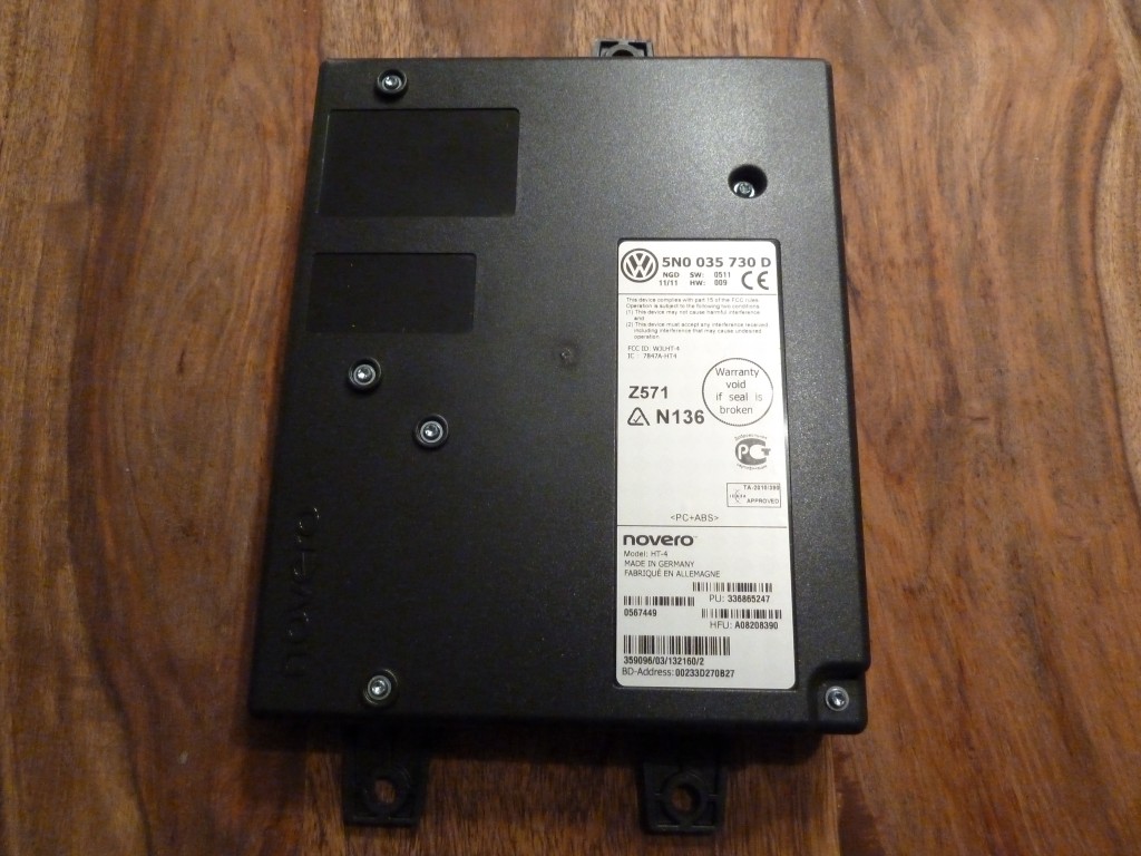

I have a device underneath the passenger seat .. It seems to an external amp or the blueetooth module ! Nothing is wrote there
Does it not have a code label (if it ends 035 730 it is a bluetooth module)?? Do you have the phone menu in the maxidot?

The problem there is no sticker on it :s am thinking of buying some of those chinese dvds , wtbout them ??
Mike is probably right but if it helps to rule it out, a bt module would look like this.
