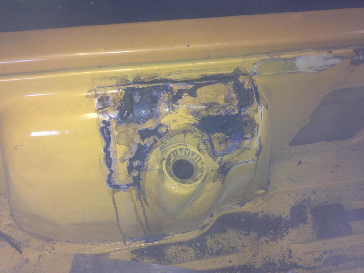

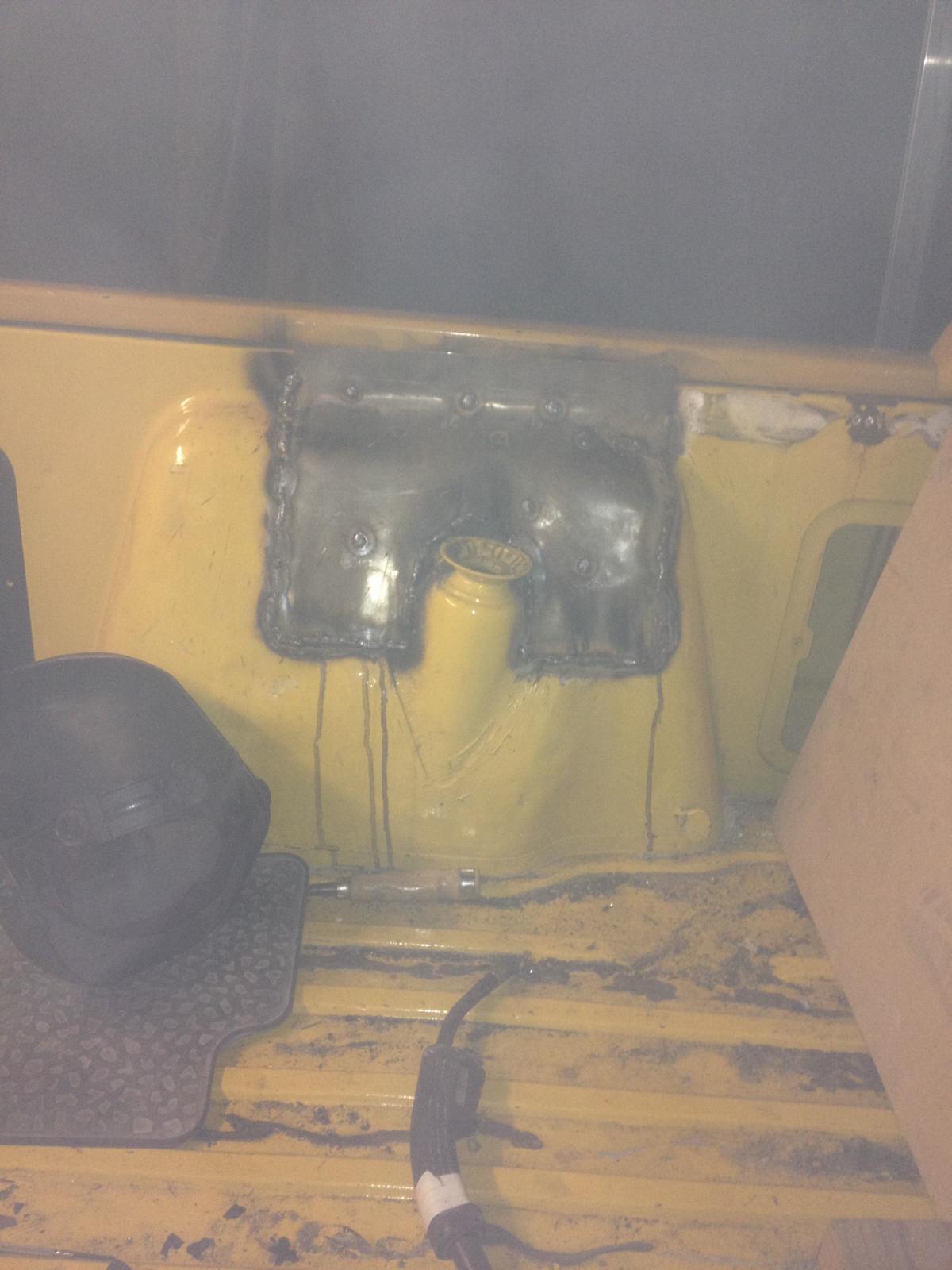

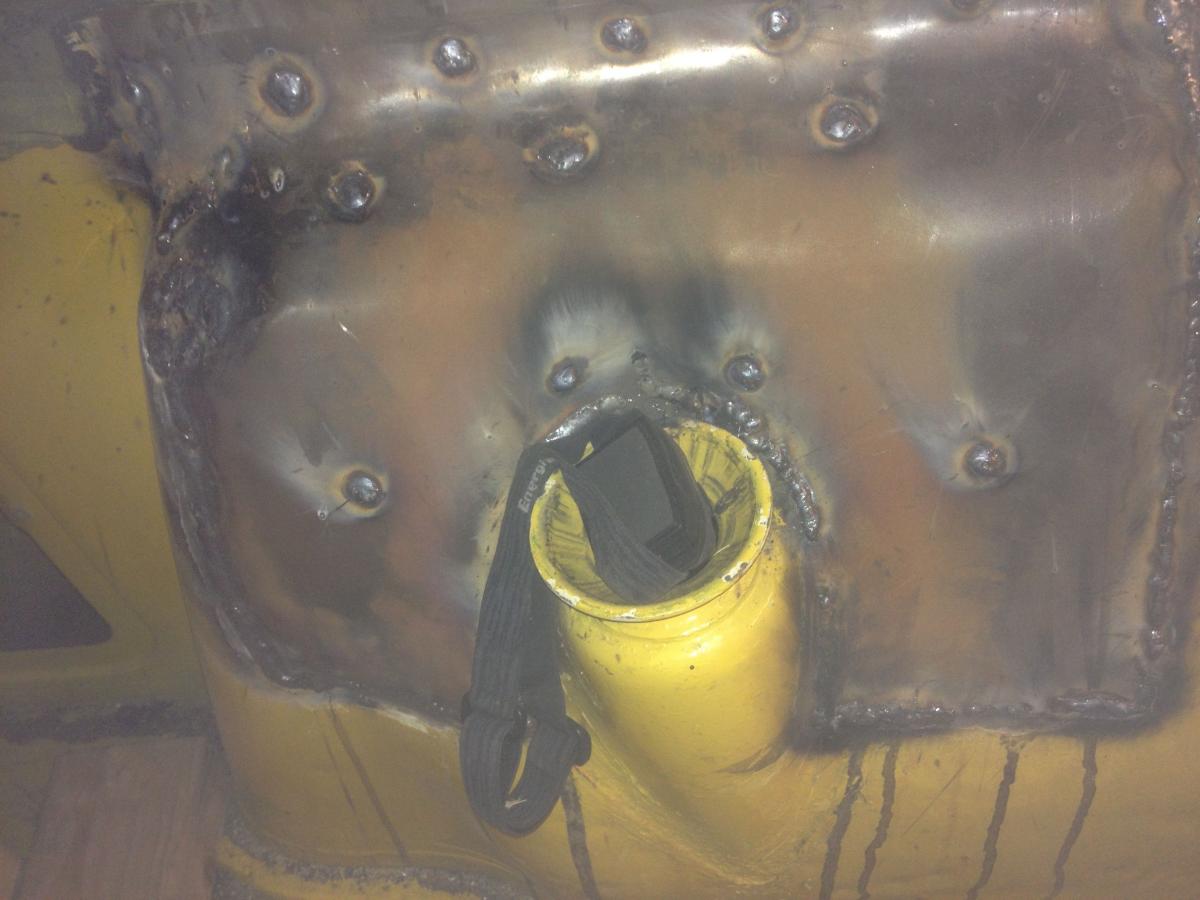

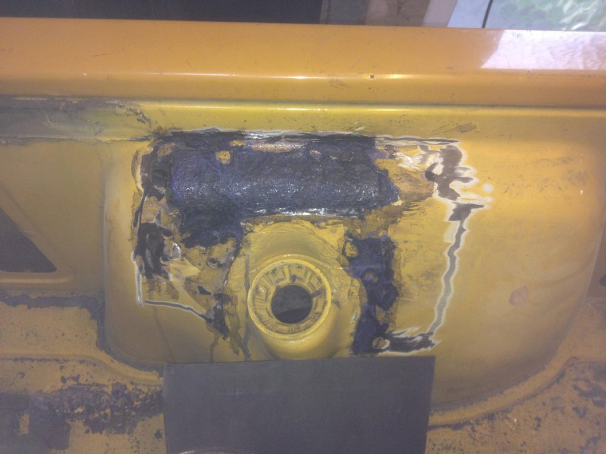

when i got my fun   the rear mount was coverd in a rubber matting  so when i got the car back  i decided to remove it  and attack it with a hammer and a wire  brush    this is what i found     after much thought  to what to do .i decided to weld it  ,   grind it  and then fill it to tidy  it up so it wont look that bad when i paint it  . i know that this is a very common thing  on the fun   so don't forget  to check what underneath  the rubber mats !!!.
hope these pics  help some one else
Hi Paul, thanks for those, sadly it's all very common on the fun and pickup for them to rust up round the rear suspension turrets.

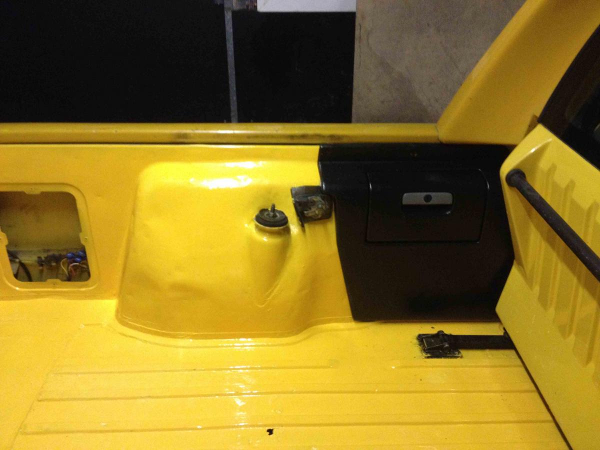

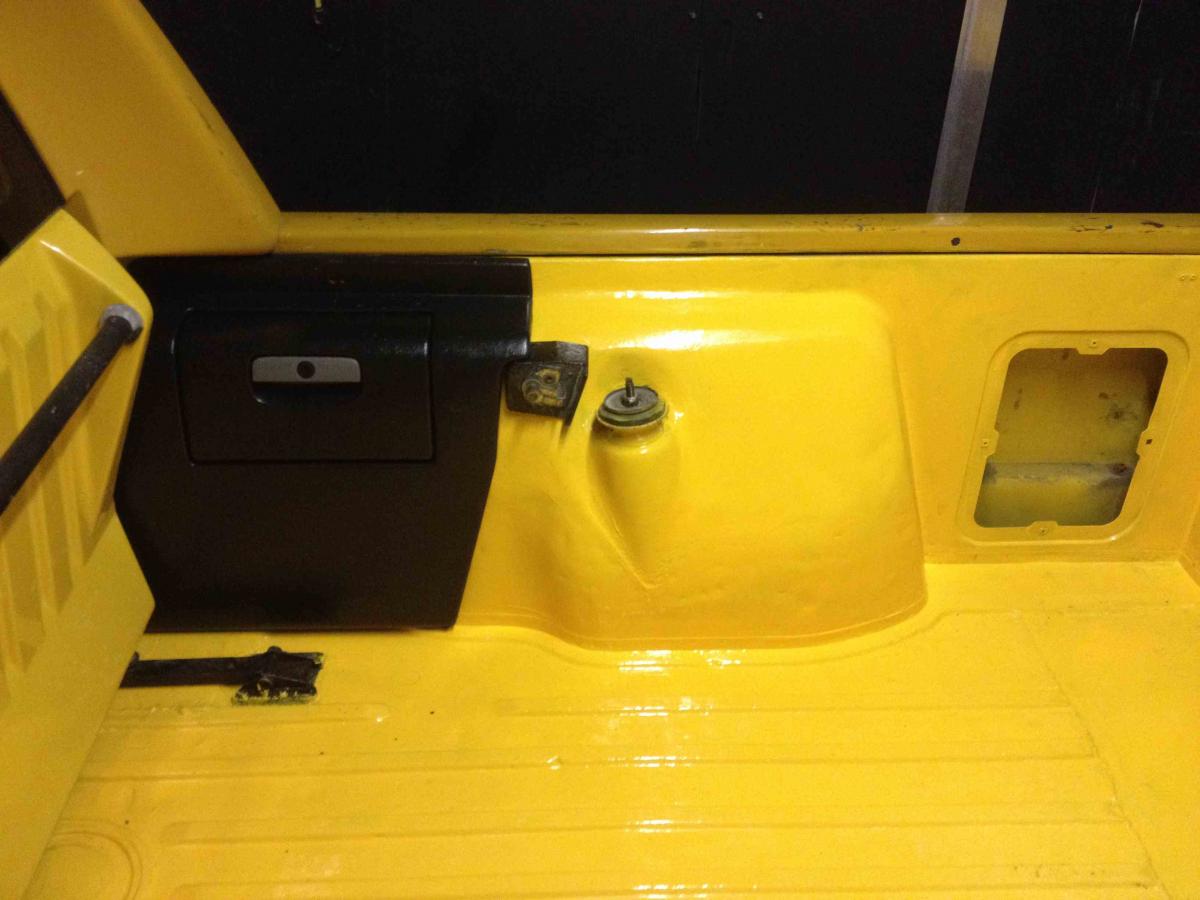

just  a follow up on the finished arches  with help  with a bit of filler and yellow  paint   to tidy the weld up.
just proves to show any thing is possible,    so don't give up on  the fun as there is not many left
