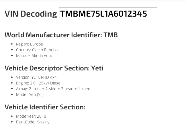

Just working on a vin decoder and now coming to test some Skoda VIN's I have a problem.
I've resolved one of them, which was year encoding... too much staring at goats.
My biggest challenge is raw vin data, anyone know a good source of raw data.
By raw data I am not after a decoder, I've built one of those this evening. I'm looking to prime it with real data, so WMI codes and VDS data.
But to get to that the raw data is needed, which I'm typing for the moment to push on with UI design etc.
Sample taken from posts on site:
wmi: 'TMB', model: '5L', name: 'Yeti', versions: [
        { key: 'J', value: "YETI, LHD 4x2" }
        { key: 'K', value: "YETI, RHD 4x2" }
        { key: 'L', value: "YETI, LHD 4x4" }
        { key: 'M', value: "YETI, RHD 4x4" }
        { key: 'N', value: "YETI, LHD 4x2, multi purpose vehicle M1" }
        { key: 'P', value: "YETI, RHD 4x2, multi purpose vehicle M1" }
        { key: 'R', value: "YETI, LHD 4x4, multi purpose vehicle M1" }
        { key: 'S', value: "YETI, RHD 4x4, multi purpose vehicle M1" }
        { key: '1', value: "YETI, LHD 4x2, vehicle category N1" }
        { key: '2', value: "YETI, RHD 4x2, vehicle category N1" }
        { key: '3', value: "YETI, LHD 4x4, vehicle category N1" }
        { key: '4', value: "YETI, RHD 4x4, vehicle category N1" }
engines: [
        { key: 'B', value: '1.8  118kW Petrol'}
        { key: 'C', value: '2.0 81kW Diesel'}
        { key: 'D', value: '2.0 103kW Diesel'}
        { key: 'E', value: '2.0 125kW Diesel'}
        { key: 'F', value: '1.2 77kW Petrol'}
        { key: 'J', value: '1.4 90kW Petrol'}
        { key: 'T', value: '1.6 77kW Diesel'}
      airbags: [
          { key: '2', value: '2 front'},
          { key: '4', value: '2 front + 2 side'}
          { key: '5', value: '2 front + 2 side + 1 knee'}
          { key: '6', value: '2 front + 2 side + 2 head'}
          { key: '7', value: '2 front + 2 side + 2 head  + 1 knee'}
          { key: '8', value: '2 front + 4 side + 2 head'}
          { key: '9', value: '2 front + 4 side + 2 head + 1 knee'}
Any ideas?
