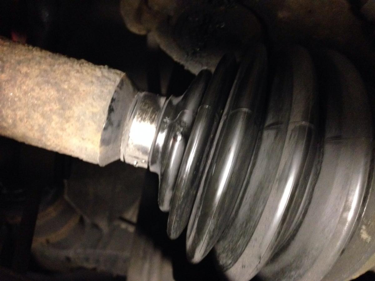

I have just jacked up the car and surprise the damage to the boot is Phillips screwdriver sized on the top of the 1st ridge (gearbox side). Do you think I should contact trading standards or go back to National Tyres? I have cleaned up the grease such as it was and put a miracle patch on the boot. I will see if this stays on over the next few weeks .
That is shocking. id be onto the trading standards personally...
Threaten National Tyres with trading standards and the local paper. Take lots of photos of it. They will probably agree to do the work for free, but tell them you want your normal mechanic to do the work and send them the bill.

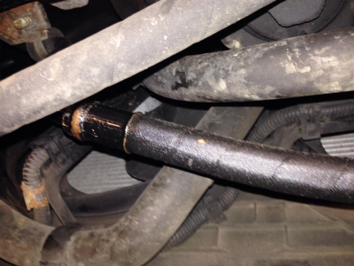

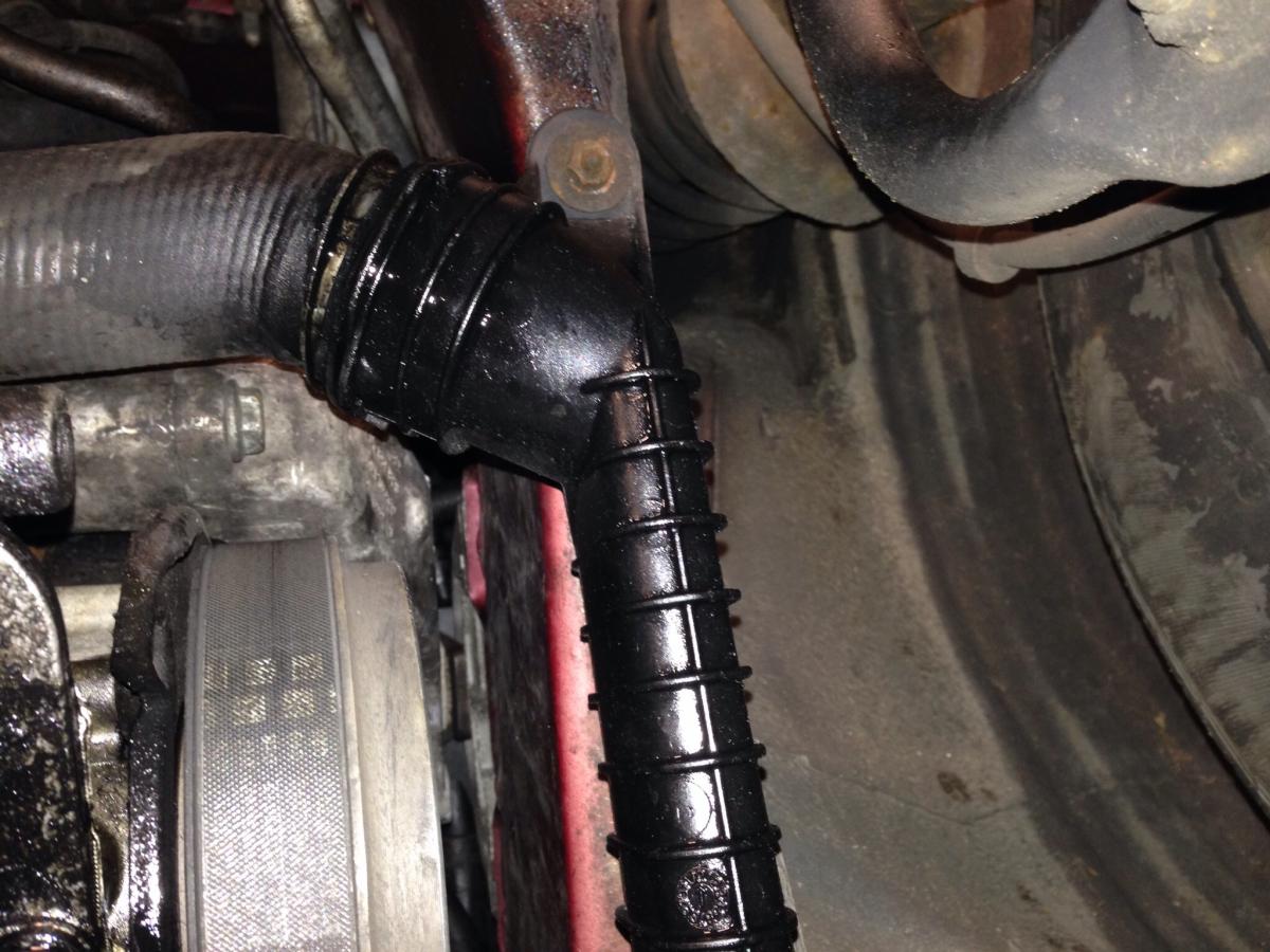

Here some pics I took whilst down there . Pic number one shows the boot. It's not fantastic quality but you can see the puncture mark. Pic two is the inter cooler pipe I think . Looks like it is about to come out and is covered in oil? Also the air con pipe was covered in some oil. Are the two pipes anything to worry about?
The grease from the cv boot is really thick, when mine split recently I had lumps of grey grease stuck around the wheel arch, inside of the wheel and various bits of suspension.  The second picture looks like normal leakage of oily muck from the intercooler pipework.
Sorry I should have been clearer. There were a few small lumps of grease as the puncture had only just "happened" - I reckon the ran it up on the rollers or even on a jack. Anyway the question about oil was to do this the inter cooler pipe which looks like it is coming out of the inter cooler - see second picture.
Leakage of oil round the joints on the intercooler pipework is pretty normal.  I can't remember now what that joint should look like so I'm not sure if it is OK or not.
Does the aircon work OK?
It was working fine in the summer. Difficult to tell at present to be honest . The car is steamy from various leaks and doesn't seem to delist effectively , and I know the recirc flap motor is U/S .

The area manager from Cambridge called me today and offered to view the damage at some point. We had a sensible discussion about it and I might take him up on his offer. The patch has worked to this point though the car hasn't been over 40mph . Tomorrow it's going for a motorways run onlyp 20 miles or so but at least it will hit 70. The oil on the bottom of the inter cooler pipe has come back and also is on the other side of the auxiliary belt pulley, but not on the belt itself. Any ideas where this might be coming from other the Intercooler?
Have you checked the seals on the driveshaft where it comes out of the gearbox. On my old car they were weeping but the motion of the driveshaft chucked it all over the place.
