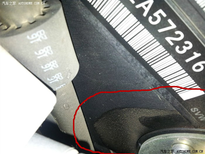

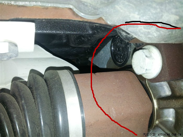

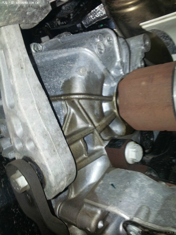

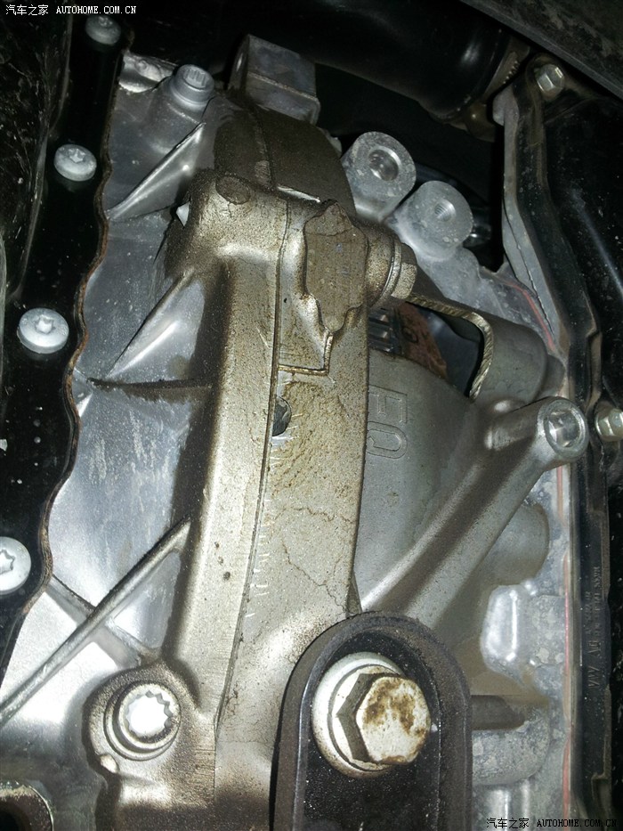

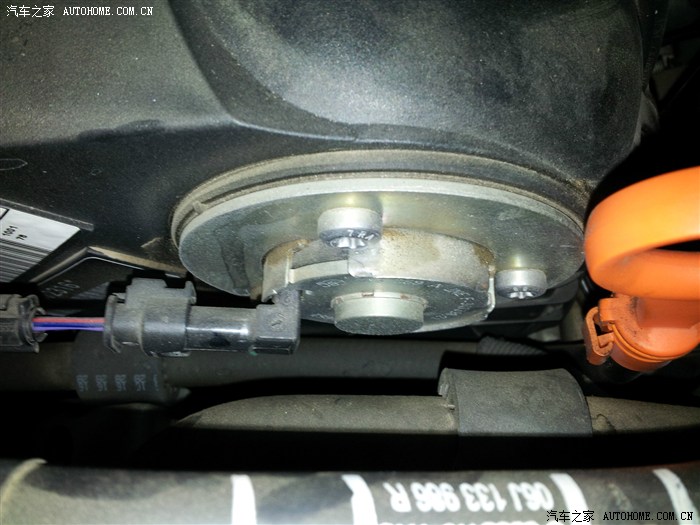

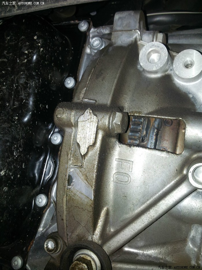

hello?everyone?I come from tianjin city.china I bought Superb II 1.8T?haorui 118 kw EA888 ? made by shanghai VW in february 2012. when i made the first service at 5,000 km in skoda service station?i found that there was much engine oil under engine and gearbox?also found in oil tight of camshaft?I asked the service satation why my car present this problems , they telled me the bleeding normal and EA888 engines bleed oil in all of world . I did`nt belived their explanation. Furthermore,there are mang cases  equiped EA888 engine.

The oil does not look to me as if there is fresh oil feeding it  as in a leak but more than likely as if some was spilt from a top up some time ago. Just my opinion.
Welcome from me too. I have the same engine in my Octavia II and it is absolutely clean with no sign of oil leaking anywhere. if I owned tour car I would clean the oil off using a chemical cleaner and check from time to time to see if there is a fresh leak.

in china,the first service is free. They told me that i should take the first service at 5000km, therefore, i went to the skoda service station.i should`t suspect my new car would appear those problems at all. But,when my car was put up by crossing lift, i found what my photos had showed, i was suprised.i could`t accept their explain, because my car is new, it should`t appear any leak. Before that,i didn`t top up oil.
