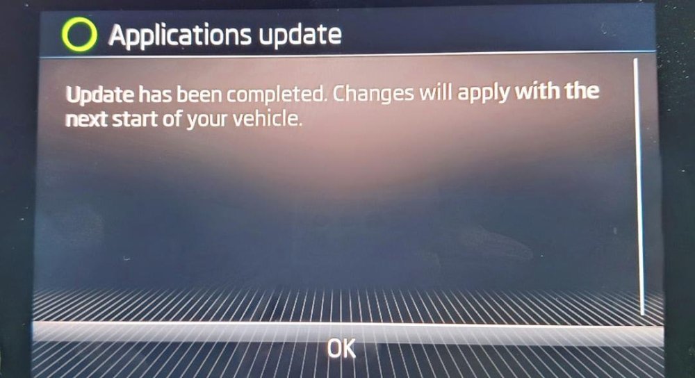

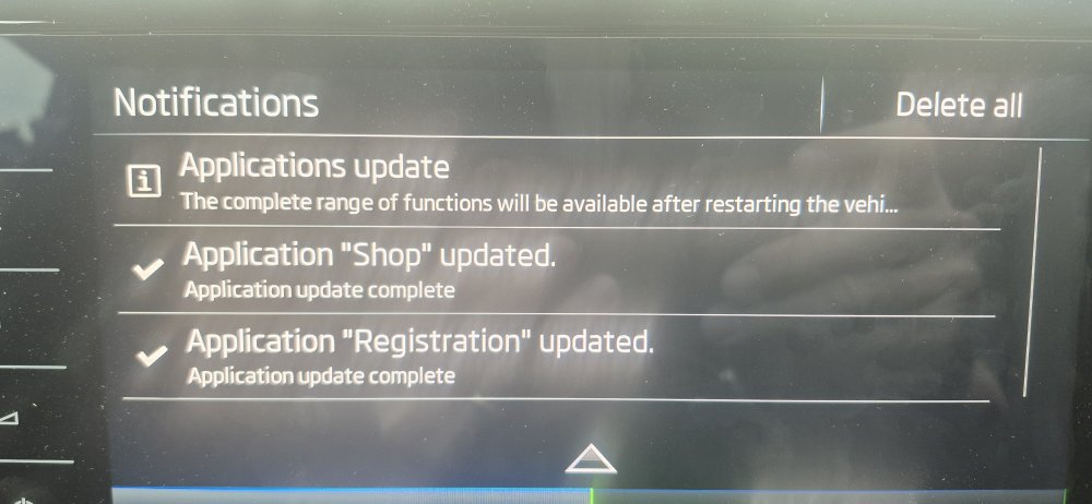

These are the updates I'm getting daily, both go to 100% and both say they've updated, and will complete on restarting the vehicle, but the next day both will come back!
I've found the Shop App, which I did know existed, so not sure if thats new. But can't find the Application app anywhere.

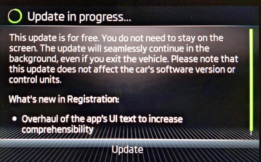

Hi,
I face the following issue some months ago :
Since then, I have regular updates as shown on @cnc 's pics above. Just on the top of the head, I would says 6 or 7 updates in the last 3 weeks...
I first thought it was always the same update that struggled going thru, but when I had a closer look to the informations, I noticed some slight differences in the content of update informations. They look the same but, they are not...
I let you check.

You may well be correct, there have been slight differences in the wording, and for the last two days I have had no notifications, so perhaps I am at last up to date. I haven't noticed anything different on the main screen, but perhaps it's a functional difference, and not obviously noticeable to the end user. I'll keep a look out for further notifications.
I had a new one this morning which is not yet completed. At first glance, once again a previous one, making you think it did not go well and had to be reloaded.
But if you look at the informations of the update content, you can see, it's different from the previous one. 😉
I just don't understand why there are so numerous updates in such a short period of time... Just from the top of the head, I would say 8 to 10 over the last 30 days.

I had to originally, a "shop" update and a "registration" update, over the last few days the "shop" update seems to have disappeared, so I'm presuming its actually completed but I'm still getting the "registration" update.
