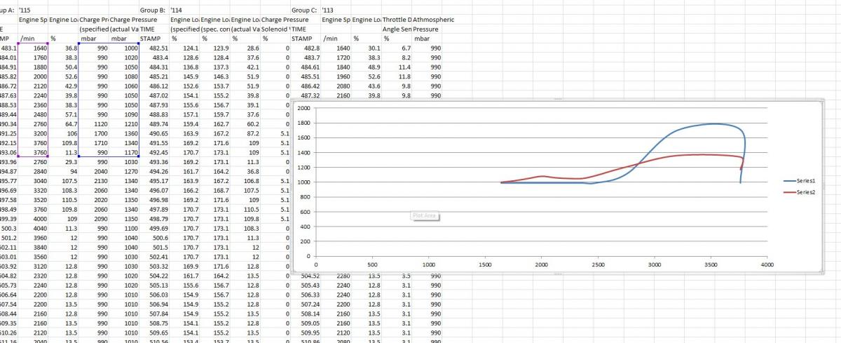

post-8833-0-09310500-1390850700_thumb.jp
This is a quick plot dug out from what you sent me, as you can see your ok up to 3k then the spec is way higher, I notice your N75 duty cycle looks low but I'm not entirely sure on what that should be doing. I'm sure it should be higher than 5.1 % though.
I'll take another dig in the files now.
That's a major problem right there- max 5% duty cycle at 100% load means the wastegate is almost fully open across the range- Bad N75 is first guess at those readings
That sounds about right I could remember which way round the reading went on the N75
In the low ranges it should be basically 100% meaning the gate is totally closed then slowly fall as it's at max boost and the gate needs to open to regulate the boost so the N75 seems to be goosed

The second log has totally different readings. That log is when it was in the limp mode.
