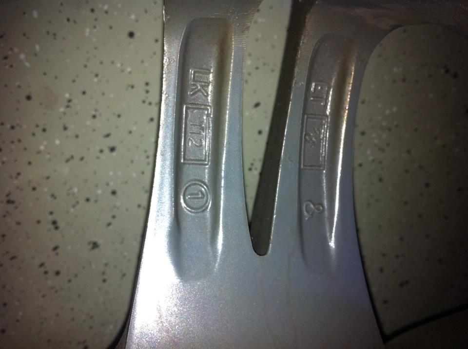

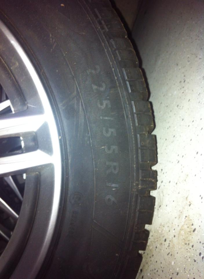

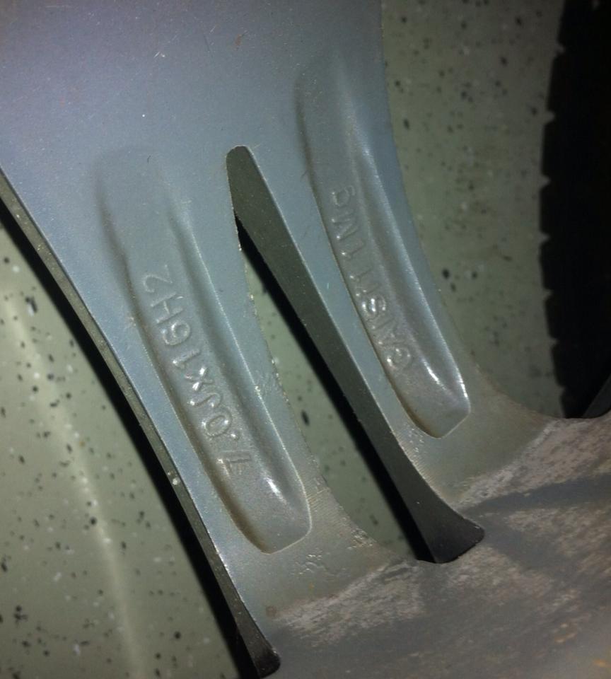

Many thanks for the quick response.  I have got the following pictures from the person with the wheels and tyres - do you think I can use them?

Rim size is OK but theres nothing clarifying the stud spacing or spigot size which has to be 5x112 and 57mm.
What where they fitted to previously :wonder:

They came off a 2011 Seat Leon
The rims should fit then as they use the same mounting.
So really it's down to you deciding if your happy running on a non approved tyre size until they wear out at 4mm.
Alternatively get the rims and fleebay the tyres and replace with the correct 215/60 or 205/55 16" tyres.

Once again many thanks.  When you say non-approved does that mean that there is any real risk involved?
Sorry but is 4mm the UK wear limit.  It's 1.6mm here I was told.
There are specification pedants -some on this forum-who may be outraged. No "real risk" though :drunk:
4mm is the max wear limit for a winter tyre to remain effective; they have additional 4mm wear bars.
Risks; local laws and insurance are about it.
Oh forgot one final thing load rating of the tyre for a 4x4 Yeti can be no less than 93/94
