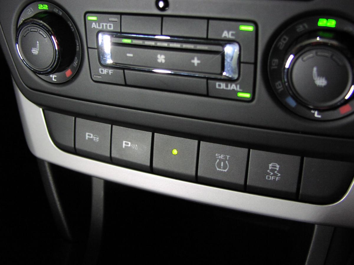

I needed to access the rear of the switch blanks below the Bolero Radio / Climatronic controls, to insert a Tri-Coloured LED for a battery status monitor. Having tracked down the relevant information with the assistance of two most helpful members here at Briskoda (Tim – TP & John – Speedsport), I successfully carried out the project. Here is a PDF of how to remove them should you need to do so for any reason – LINK
NOTE: To remove the switch blanks you must also remove the bezel around the radio (LINK to PDF that shows how to remove the radio which include the instructions for the bezel).
Hope it helps.............Tony
