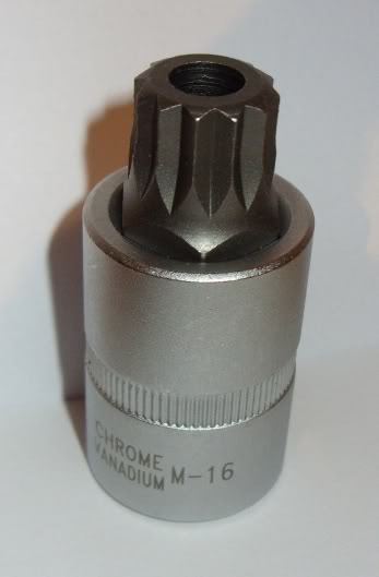

On my old 2005 (6 speed) Fabia VRS MK1 see below..
Just squeeze oil out of bottle into level/ fill hole until oil runs out, on level ground, (no other apparatus required)
