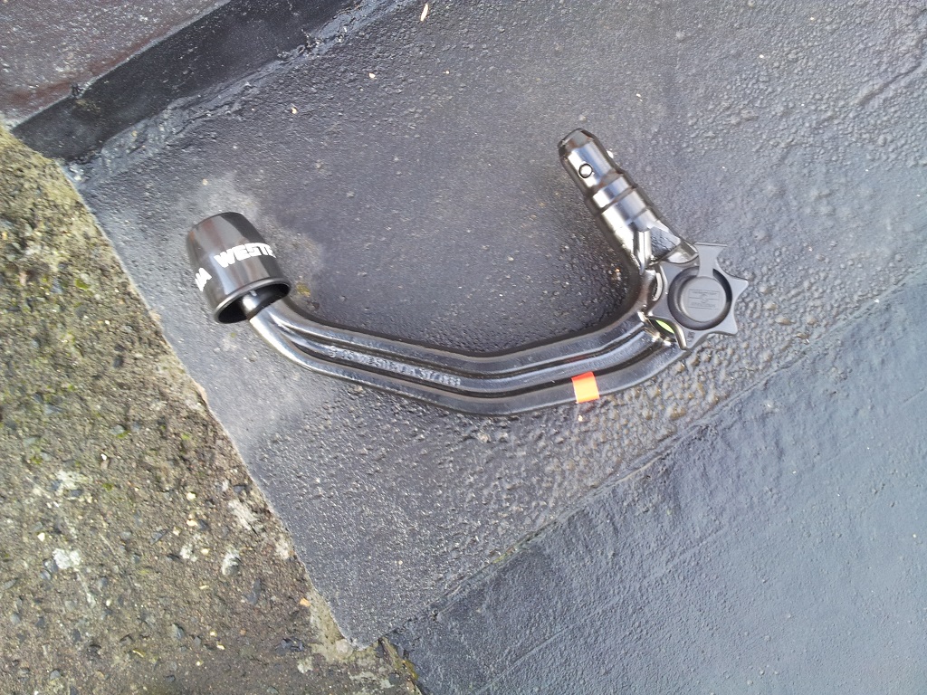

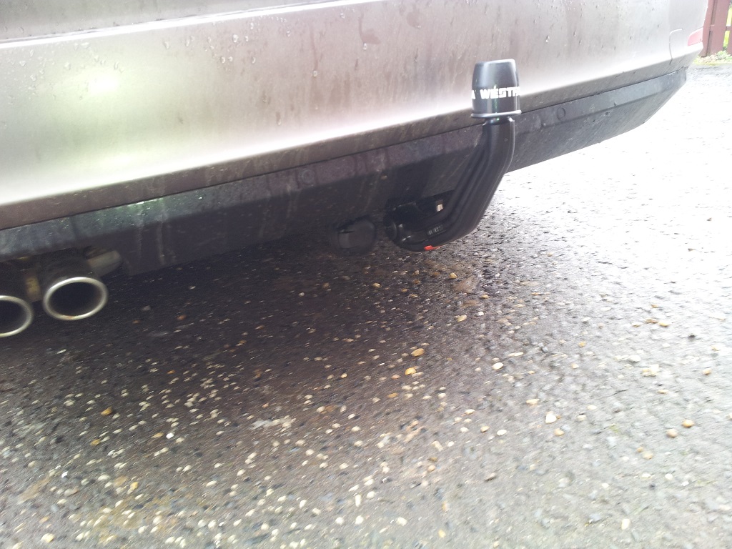

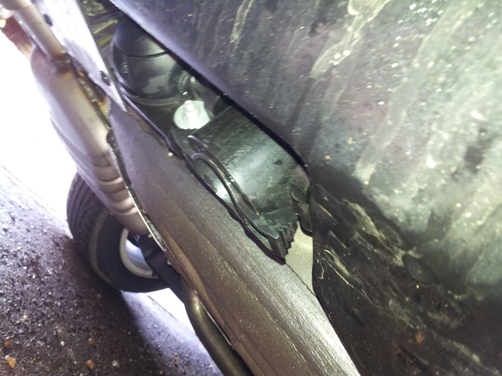

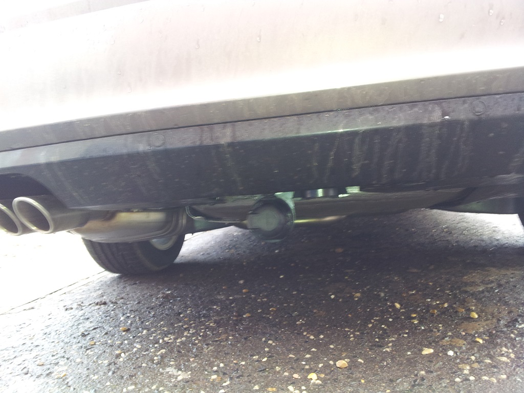

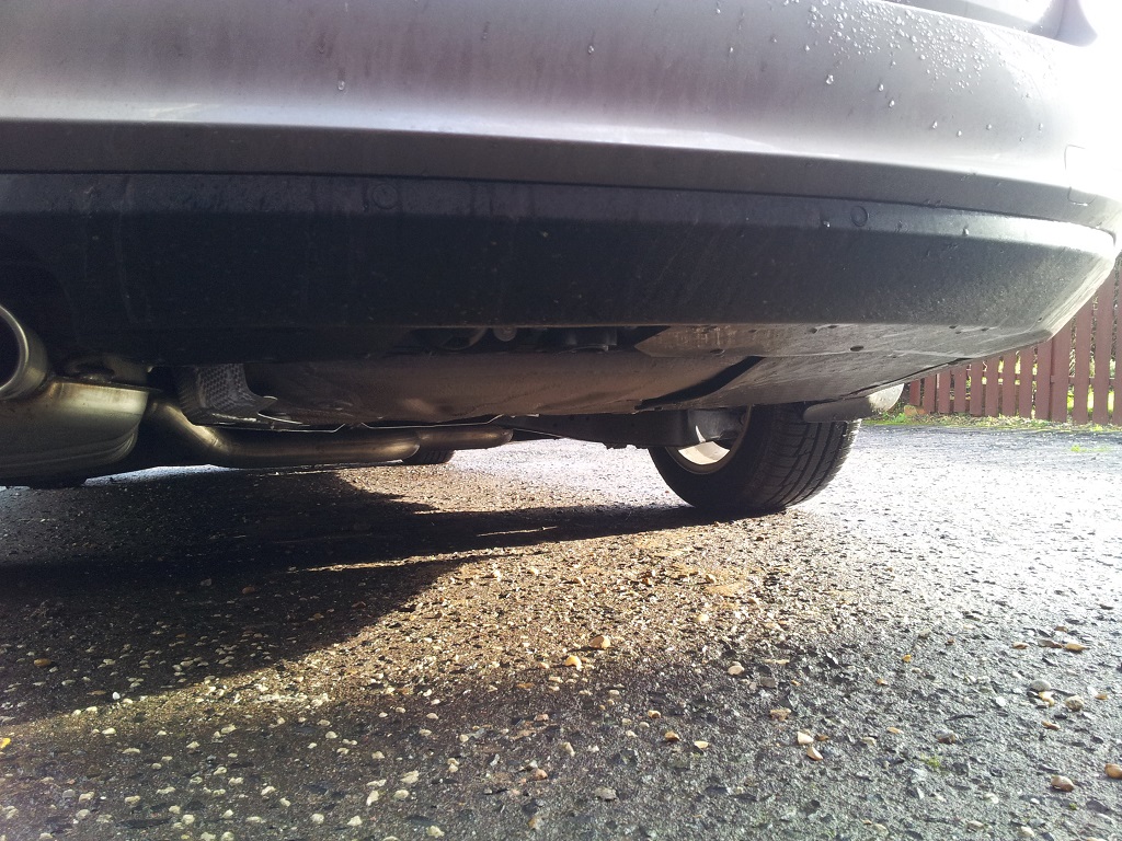

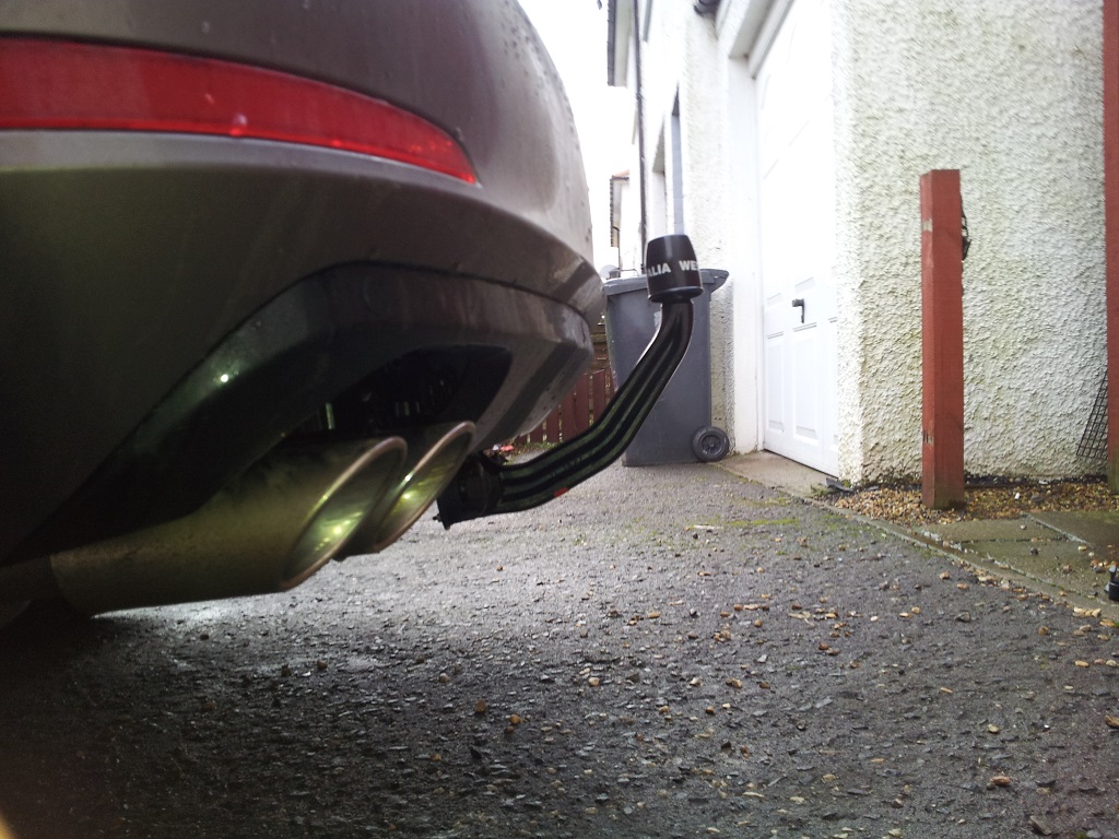

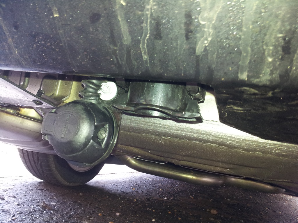

pictures please???? on and off if possible?how do you like the car honey monster?
Hi p5stokes.
Right apologies for picture quality as moved house and havent found box with main camera so taken by phone  :).
Also weather not so good so not staying out too long.
As to car loving it just came from a 2012 Vauxhall Antara 4x4 184ps auto which was only giving me 26mpg solo and 20 mpg towing. Ok the superb a little more awkward to get in and out of being war pensioner lol seems strange saying that at 48 . :giggle:  but the comfort once in far greater and fuel economy, as you can see from previous vehicle more than happy with 48 i am already getting indicated. Anyyway back on topic here are the pics of dealer fit detachable westfalia towbar.
post-109690-0-97087100-1391601817_thumb.jpgpost-109690-0-22966200-1391601822_thumb.jpgpost-109690-0-07721600-1391601825_thumb.jpgpost-109690-0-47398600-1391601828_thumb.jpgpost-109690-0-29576600-1391601831_thumb.jpgpost-109690-0-58691200-1391601834_thumb.jpgpost-109690-0-87665900-1391601837_thumb.jpg
Hi p5stokes.
attachicon.gif20140205_112845.jpgattachicon.gif20140205_112908.jpgattachicon.gif20140205_112959.jpgattachicon.gif20140205_113044.jpgattachicon.gif20140205_113059.jpgattachicon.gif20140205_113154.jpgattachicon.gif20140205_113219. net job, thanks much appreciated. paul
I've a removable Witter towbar on mine. I never had any intentions of towing when I bought the car and then we bought a folding camper a couple of months later!
I took the car to Rotherham Towbar Centre who supplied and fitted it and coded the car to be trailer aware. They cut out the bumper and the electrics hinge down.
My towbar, though removable, is of the traditional flanged variety rather than a swan-neck.
One word of advice though - when the bumper was refitted it was slightly mis-aligned. It wasn't obvious until the paint chipped at the bottom of the rear door after catching it every time it shut. I took it back and they adjusted the bumper (some 18 months later so happy with the aftersales) and a spot of touch-up paint will sort the chip.
