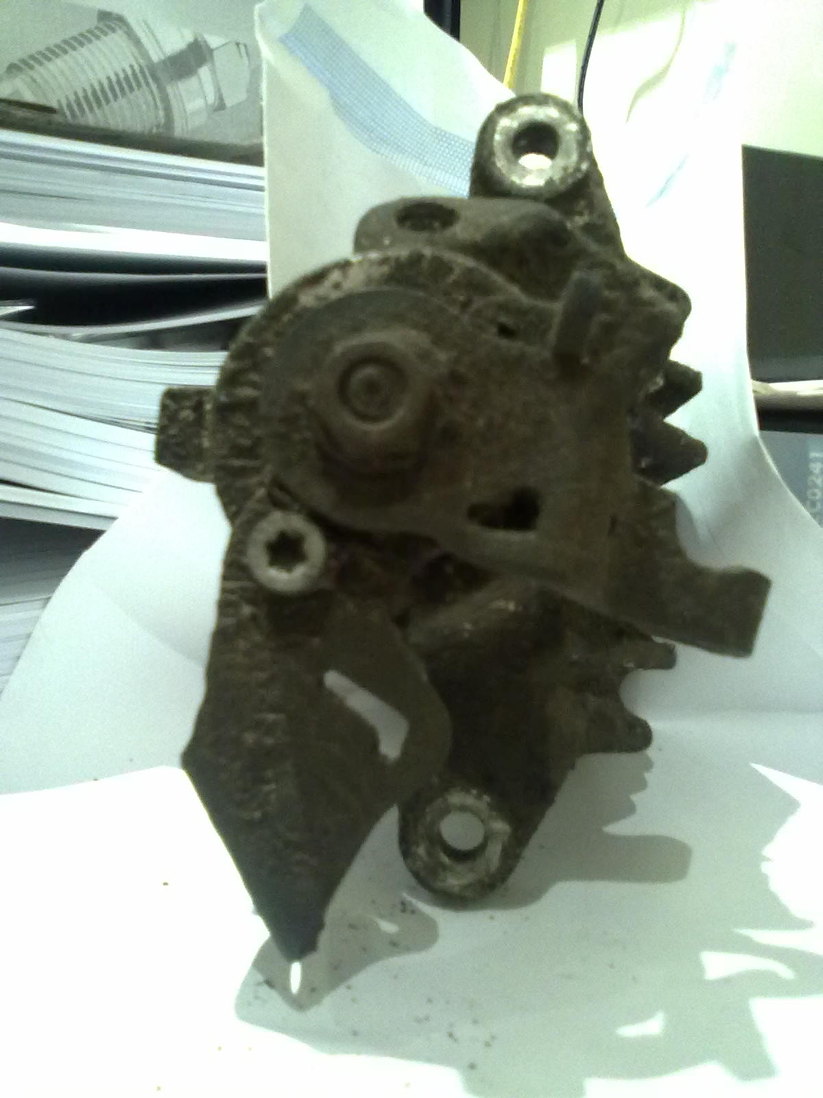

Here's a pic of the backside of the right side rear caliper I took off my Octy Mk1 1.8T 4x4. Sorry about the fuzzy 'phone quality. The lever is retained by a 13mm nut, and there is a Torx headed (sorry, can't find size at present) bolt securing the bracket into which the outer cable fits. Can't say whether yours is similar, but hope it might help you.
Meant to update this earlier - that's the same as mine's, yeah. I got them off this afternoon, I had already taken the 13mm nut and torx bolt off but the bracket(s) needed a bit of gentle (read brute force and ignorance) persuasion with a mallet.
