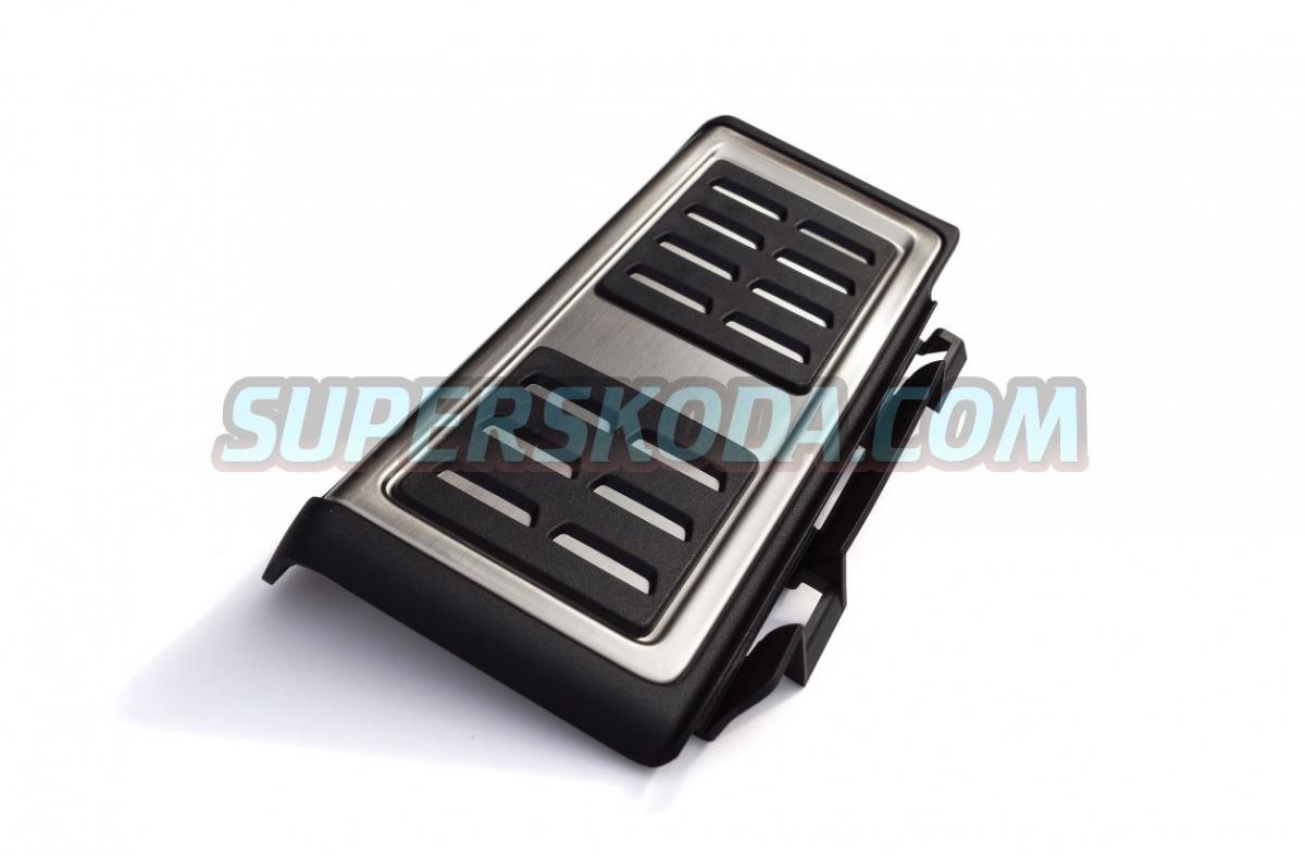

Anyone changed the footrest?
Have ordered this footrest, and wonder if anyone have changed it?
I'd be interested in knowing also as this is on my list of things to buy in March.
Is this a replacement for the left foot rest or to go over the wheel arch for your right foot, similar to the Octy II?
In Norway (LHD), it is a replacement for the left footrest. After a closer look it is not the same for the RHD.

I see. It's a manual, as i understand there is no difference on the footrest if it is a LHD.
I changed my pedals and footrest on my LHD O3.
Clutch and brake pedals are very easy.
Accelerator pedal needed some lubrification.
For LHD footrest you need to:
- take off the hood opening lever. First remove the plastic clip which keeps it on its axle then just pull it out. Don't lose the plastic clip !!!!
- unscrew one plastic screw
- pull the lateral plastic cover so you can unclip the original footrest
- clip the new footrest and put back everything as it was (plastic screw & hood release lever)
By the way, manual and DSG footrests are the same. Pedals aren't.
