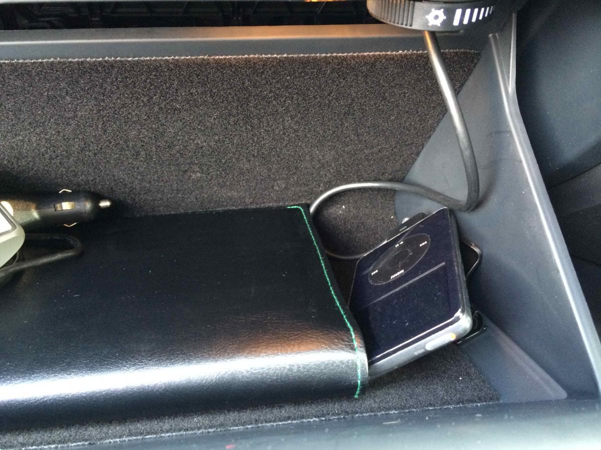

Nice work! I have an ipod touch a a black suede ipod video sleeve and can just about hide above the sliding cubby as it's quite slim.

I don't want to use my phone for my music and also don't like the cable being squashed into the phone box having to constantly plug and unplug it also allows me to navigate playlists and go to different sections of the iPod (audiobooks) without having to navigate them on my phone which you can't do via Bluetooth through the touch screen.
I have a iPhone 5s which if from what I have seen on here the lighting mitsumi cable costs a fortune mine cost me about a tenner.

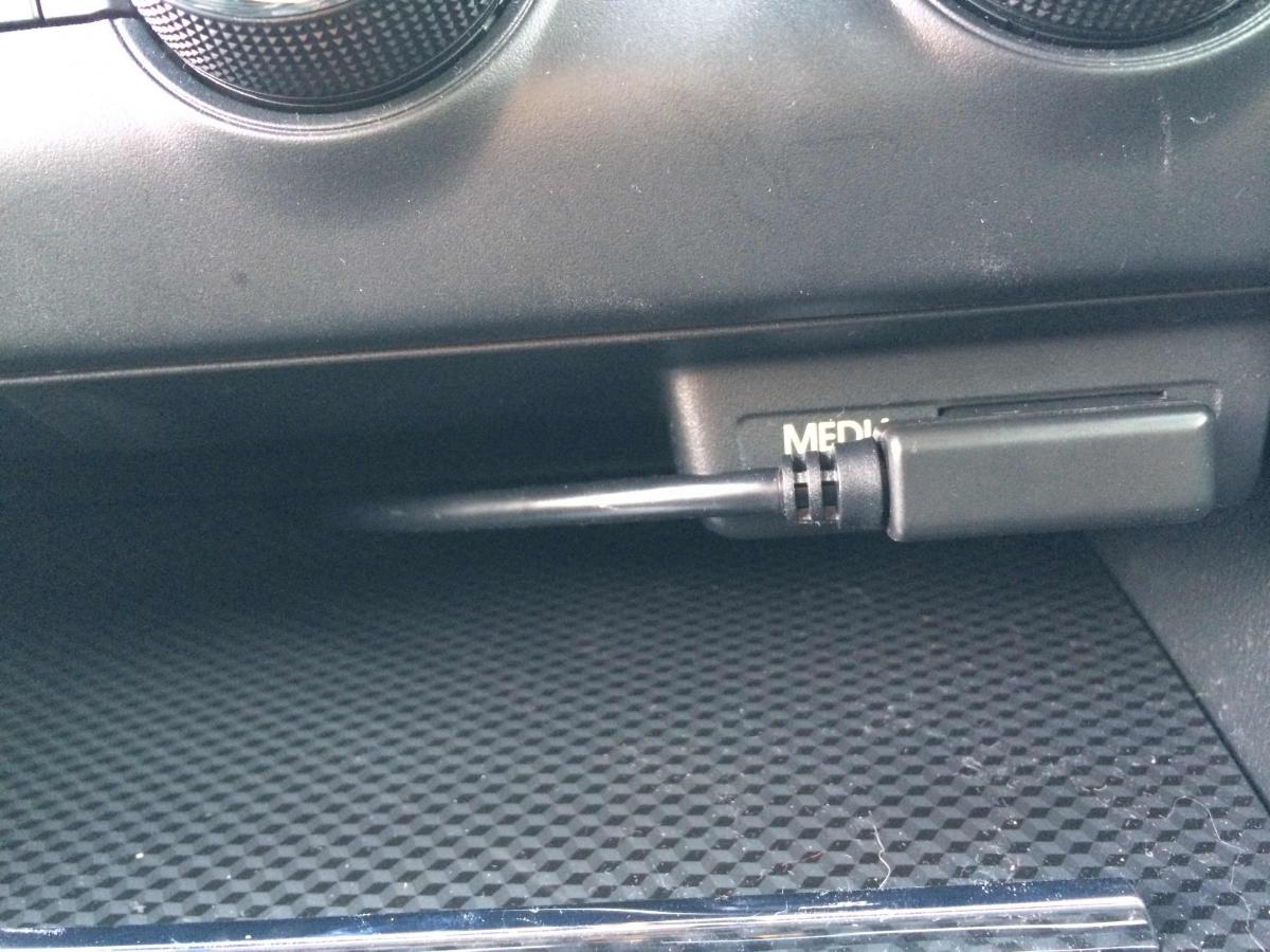

This gives me the iPod in the glovebox with the cable disappearing into the dash making it almost impossible to see from the outside.
Skoda - having the USB+AUX not inside the phonebox "simply not clever"

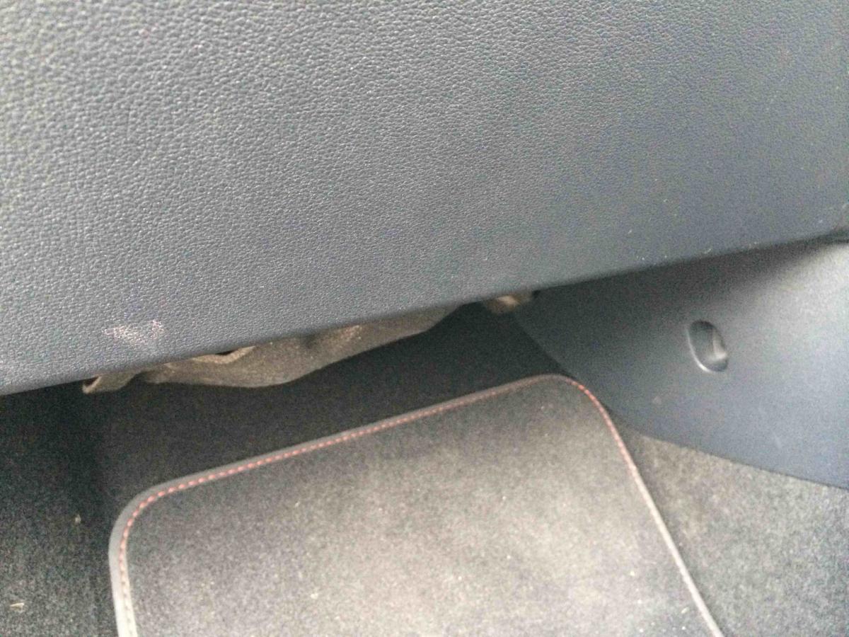

Yes it was open the glove box and you can simply feed the cable up the back of the glovebox and then in between the CD/SD module grab the cable and pull it through. I then tucked the rest of the cable behind the foam sound insulation in the passenger footwell.
