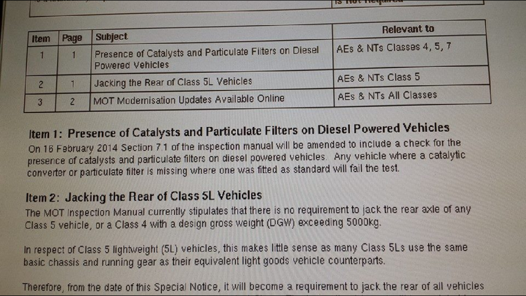

Some new legislation came on stream at MOT stations 2014 February 16th.
Is it legal what you propose, or have a chat with MOT tester perhaps?
I'm sure it could done, but why would you bother going to all that trouble?
There is a thread a couple down from yours worth a read before considering a decat, it will basically become a legal requirement to have a cat fitted if there was one put on from the factory (regardless of if it passes emissions) . Regardless if you have a 'friendly MOT tester' best bet would be miltek.

Or wait until March time, when I'm sure many 2nd hand decat pipes will be cropping up due to this new legislation (******s)..
To be fair it's about time they clamped down on stuff like dpf removal, it will be ecu modifications next I bet!
