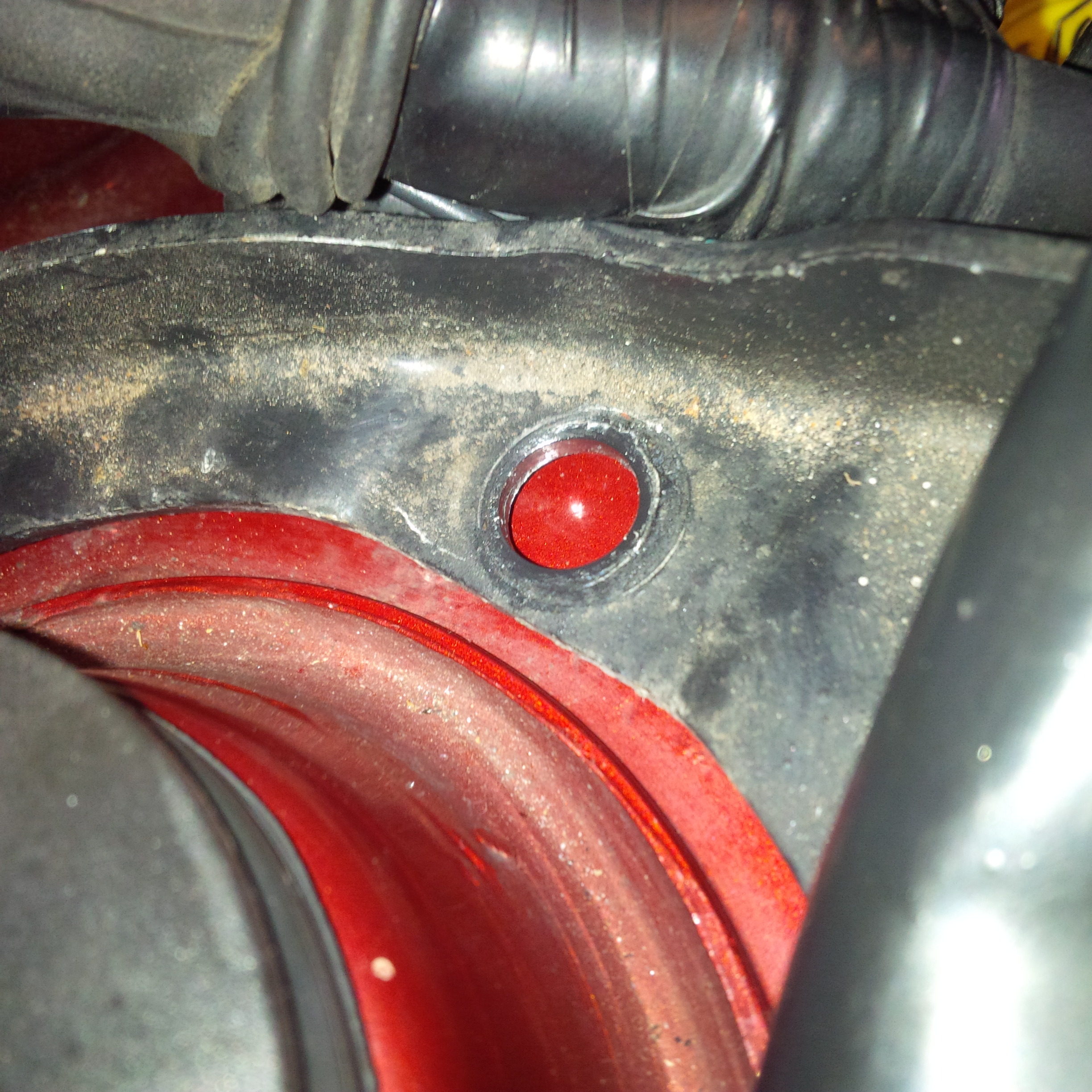

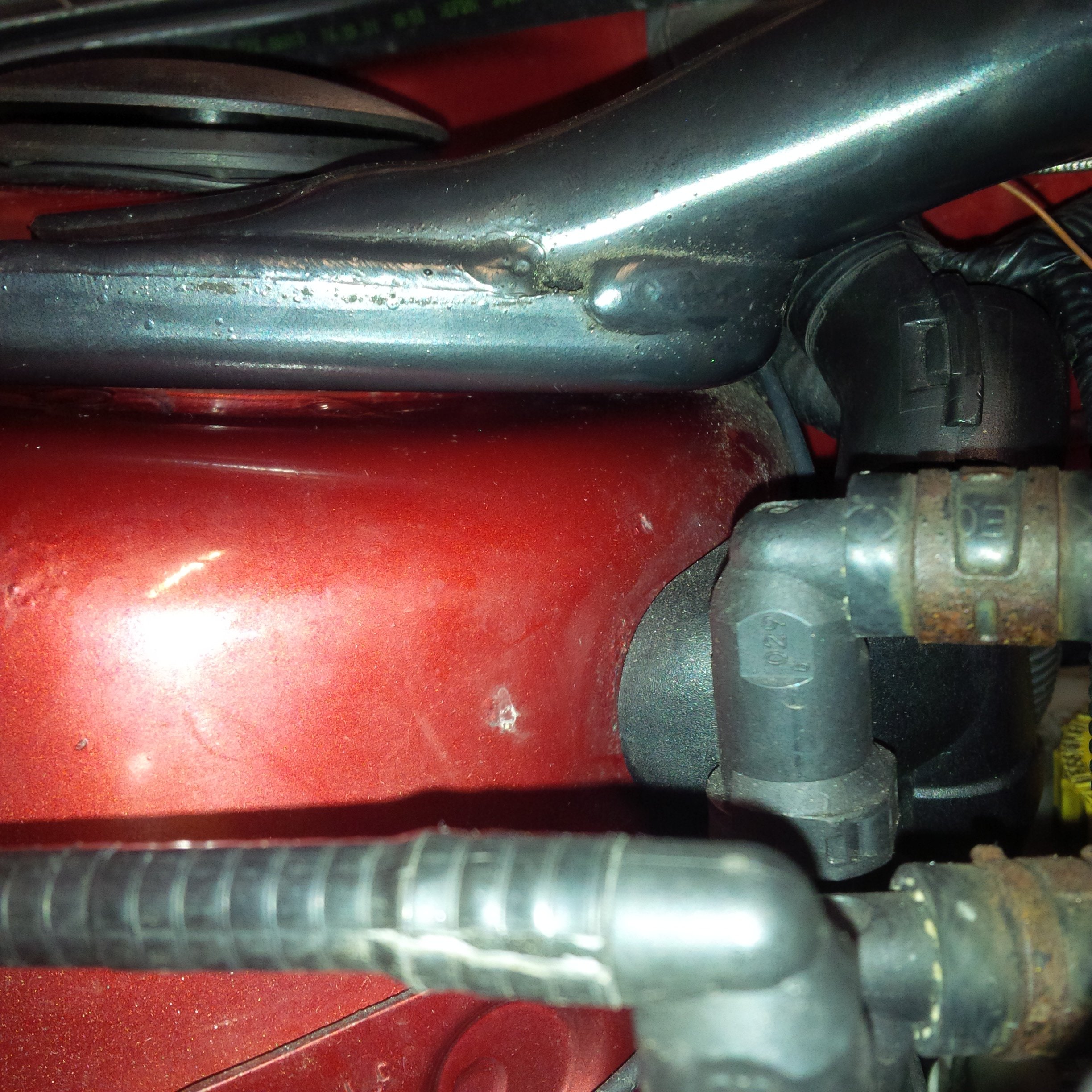

Mines a tt strut brace, brackets removed, then smoothed

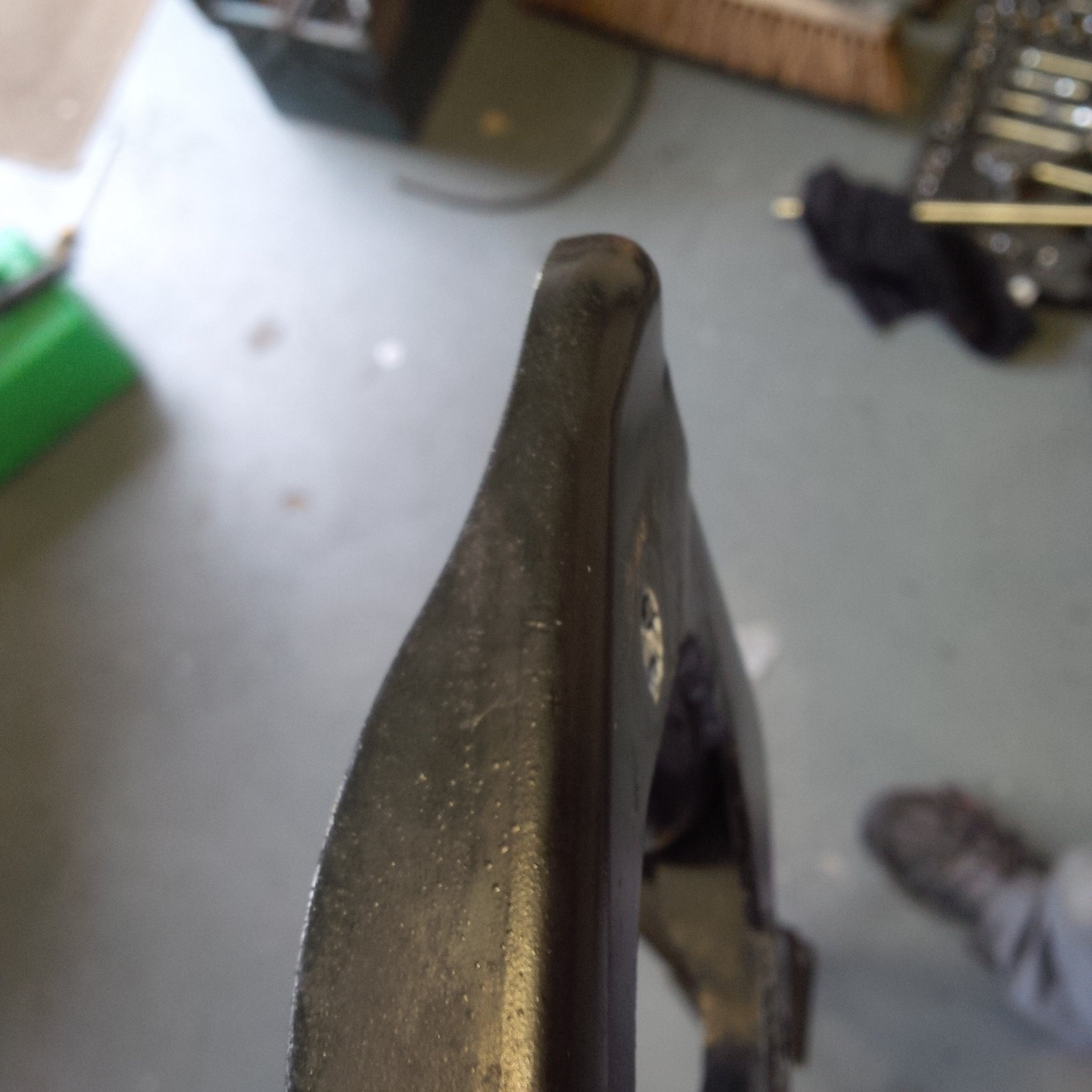

Don't mean to bring up and old thread but the tt brace has a rather large gap at one of the bolt areas where the other 2 are flush and on the other side all 3 are flush.

Interesting........... when I fitted my TT strut brace many years ago it apeared to sit flat on both sides. I used M10  stainless steel bolts / nylock nuts and washers.
Has the car had a front end ding or parked on an uneven surface repeatedly???. Saying that tho' they are buit like tanks (NB: Skoda used to build tanks in WW1 :)).
When its bolted up it will sit down on the suspension turret, personally I wouldnt worry, all cars flex to a certain degree.

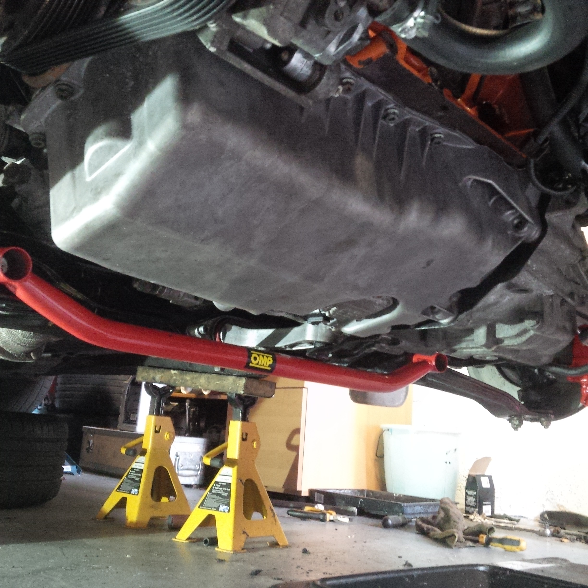

I'm more thinking the car the tt brace came off was in an accident. noticed the lower corner looks a little strange. Should have just got an omp brace for the top. I have fitted a bottom one but unfortunately it grounds out on things :(
