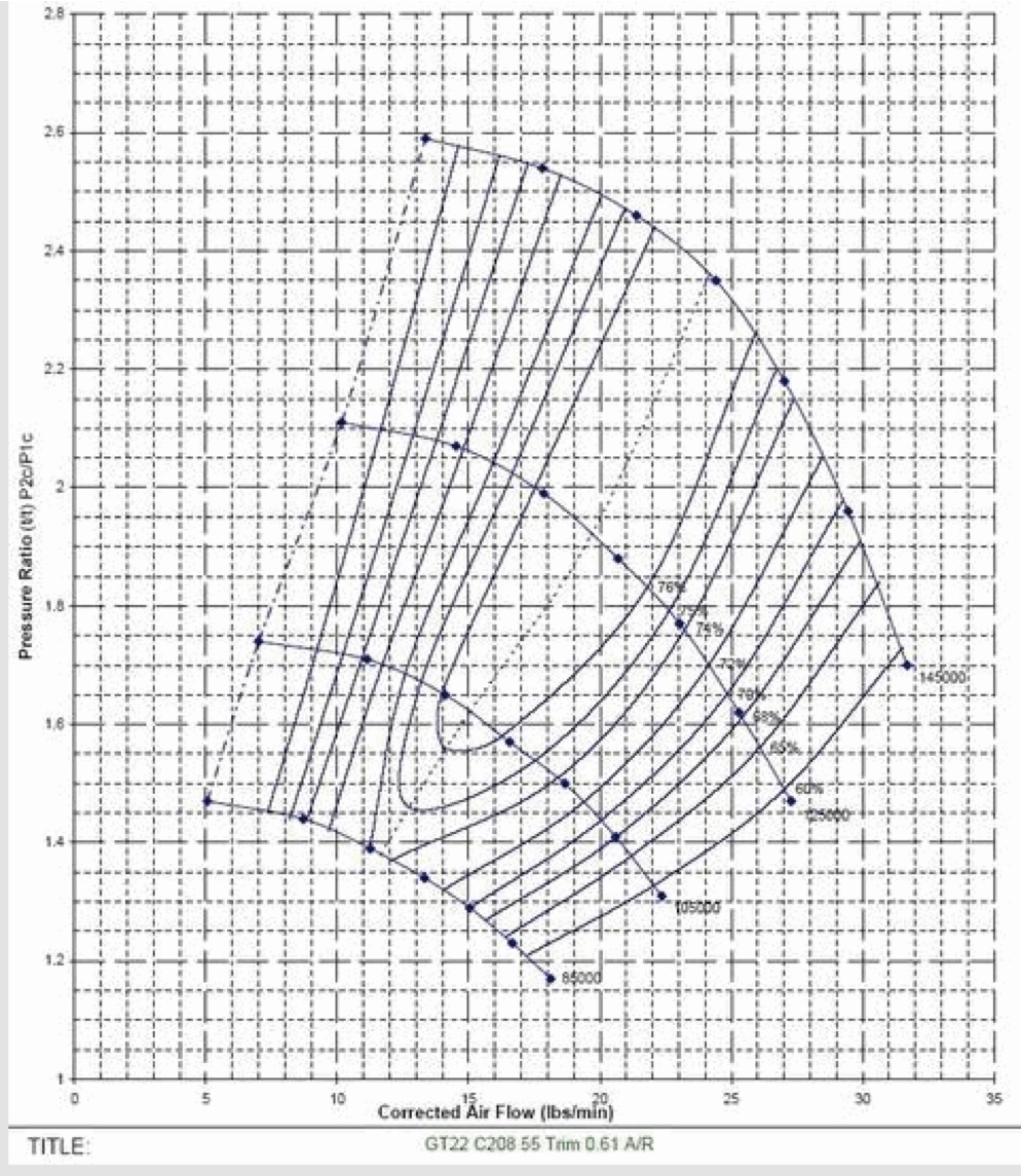

Does nobody bother looking at turbocharger flow maps and actually calculate injector sizes/fuel pressures to suit? :S Half an hour with a pencil and paper will save you a huge headache and will tell you what you need to get to where you are going...

It's a lot easier than it sounds. The standard power is known, the standard boost pressure is known, as is the engine size. Work out what the cfm is for that power on this engine, gives you a baseline to work out your required cfm for a given power level. This means you can work out a pressure ratio and corrected air flow, which is what you need in order to check out compressor flow maps. Injector size is the easy part. Assumng a stock fuel pressure of 36psi (most manufacture cars) then:
(Desired bhp x bsfc x 10.5)  = minimum required injector in cc for that power level.

vnt just refers to the fact that it's a variable vane compressor, check the housing on the turbo it should give you a model number for the turbo. Google a flow map and compare it to your pressure ratio and air flow to find out if its right!

Like I said the compressor maps are a secret. You try and find a compressor map for a 1749va/vb/vc, 1756 etc :)

I think I might have some maps - reason being that I started to help Alan Allard with research for 2nd edition of his book.
Lmao. So which turbo is this? And don't say gt1749v as theirs hundreds of different ones, each different from manufacture to manufacture. Eg vag gt1749v is different to an fiat gt1749v. By different I mean compressor and turbine sizes. Bmw have difference 2260 models. Some are from the gtb family some arnt. Again all different sizes.
gt2260v compressor map attached.
