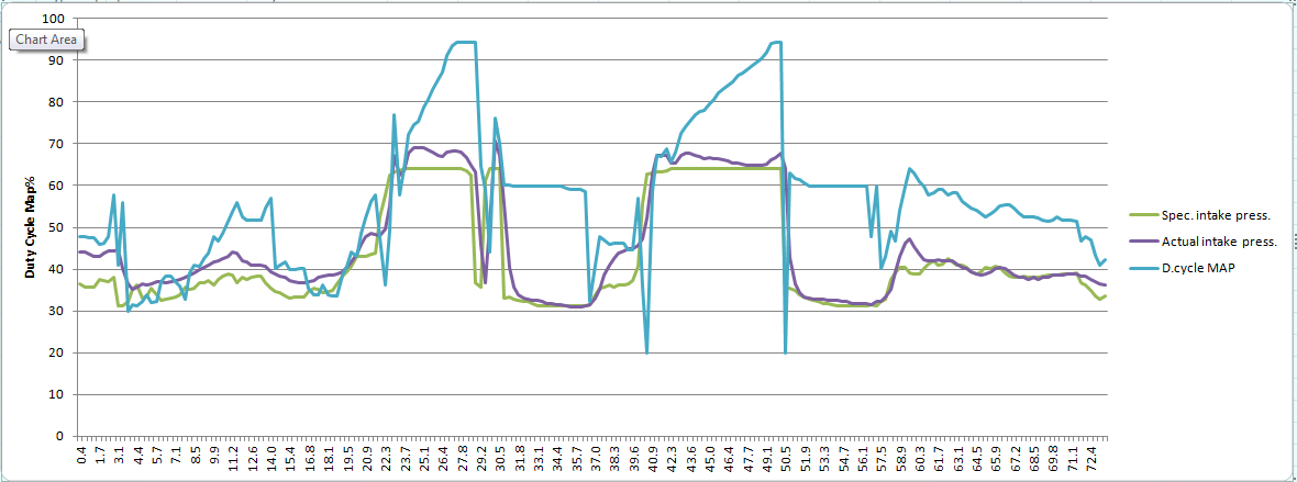

Boost log with boost actual/spec scaled near duty cycle. I have been told that high duty cycle means "vanes please open". I have checked that it is not sticky vanes, the lever moves nicely against spring resistance, actuator holds vacuum, replaced all vacuum hoses. Does anyone know if the vacuum solenoid blocks all do the same job, the different variants A-G or so? Maybe I should get a later variant if they are improvements on each other?
3rd gear 2k rpm WOT
I don't think the graphs say much except that boost i struggling to be controlled. Many thanks for the replies

This new block buzzes after shutdown. Is this normal? Things seem quite a lot better. I haven't had the opportunity to do a boost log yet. Cheers
Things feel better sometimes but I am still getting overboost. I don't really know what to proceed with now. duty map cycle is hitting 90+ which is bad right?
