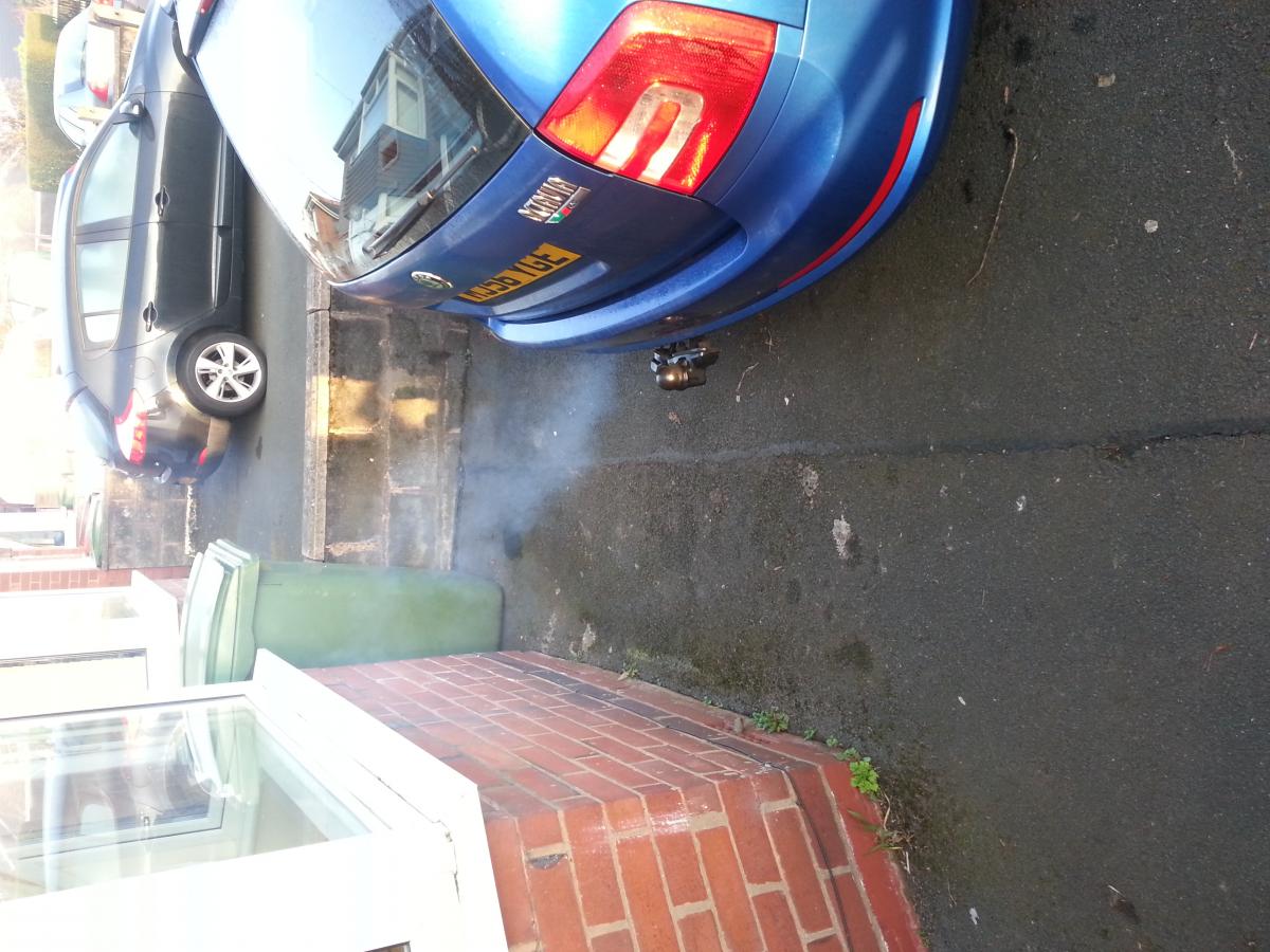

octavia vrs tdi ( blue smoke on startup ) how much for valve guides/ stem seals
doesn't look too bad why not try a pipework and intercooler clean first
